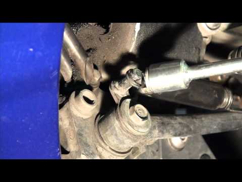

            I use my Brake Spring tool.. like this!
            I use a brake spring tool, like this vid shows... but if you don't have this tool, I have used a large (#3) phillips screwdriver too, to lever it on... but of course it's always nice to take it all off, clean and paint it !!
