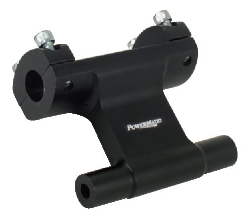

                          I definitely need the bars to be closer more than needing them higher - the Rox option gives you all that range of motion to experiment with.
                          Something similar I found was this - the PowerMadd Power Riser. It comes in different widths. I believe it's intended for off-road machines but I'm not totally sure, and that shouldn't matter as long as it fits. It's not as elegant as the Rox, but it removes the risk of bars not being parallel.
