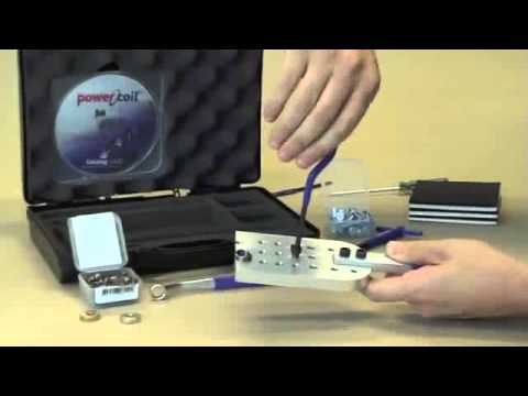

            I wasn't sure about removing them, so I looked for this on youtube.
