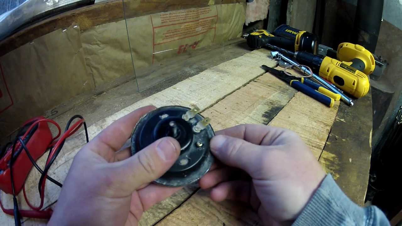

                            It adjusts the gap between the contacts. Just screw it a bit in both directions and observe the results........

                              Here's a short video that shows how they work and how to fix them...........
