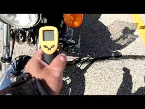

I also own and use a temperature laser -
I point it at the headers and they all read within a degree or two of each other as well--

Originally posted by jsandidge View PostOut of curiosity, what temps do your headers generally read?
Well -- I was afraid someone was going to ask that question... I generally do not remember the numbers - as long as they are similar...
I am going out for short ride at lunch and will take note of the temps and post them here...
Last night after changing the plugs and idling for a few minutes they were all at 94-96 --
But that was only a few minutes -- Better ride coming shortly...
Ride finished - results below
Ambient tmps outside 65-70 light breeze moderate sun
Ride for warm up about 10-15 minutes of 45-55 mph
Header temps start around 123 degrees and go up as it idles into the 140s
As previously stated they are all within a few degrees of each other so I know they are all firing and operating similarly
