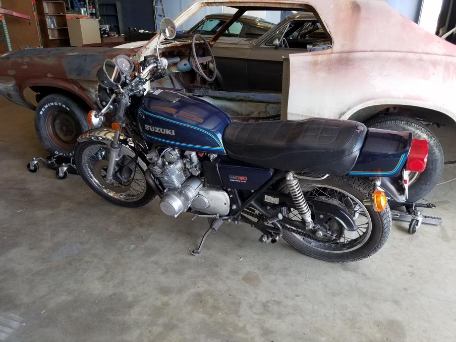

                Sorry I forgot to mention it's a 1978 GS750. I started a project thread here when I bought the thing but I love riding it so much I never started the project.

                      Thanks for the pic. That's a good looking bike. As others have said, just ride the snot out of it and it will let you know when it needs something.
