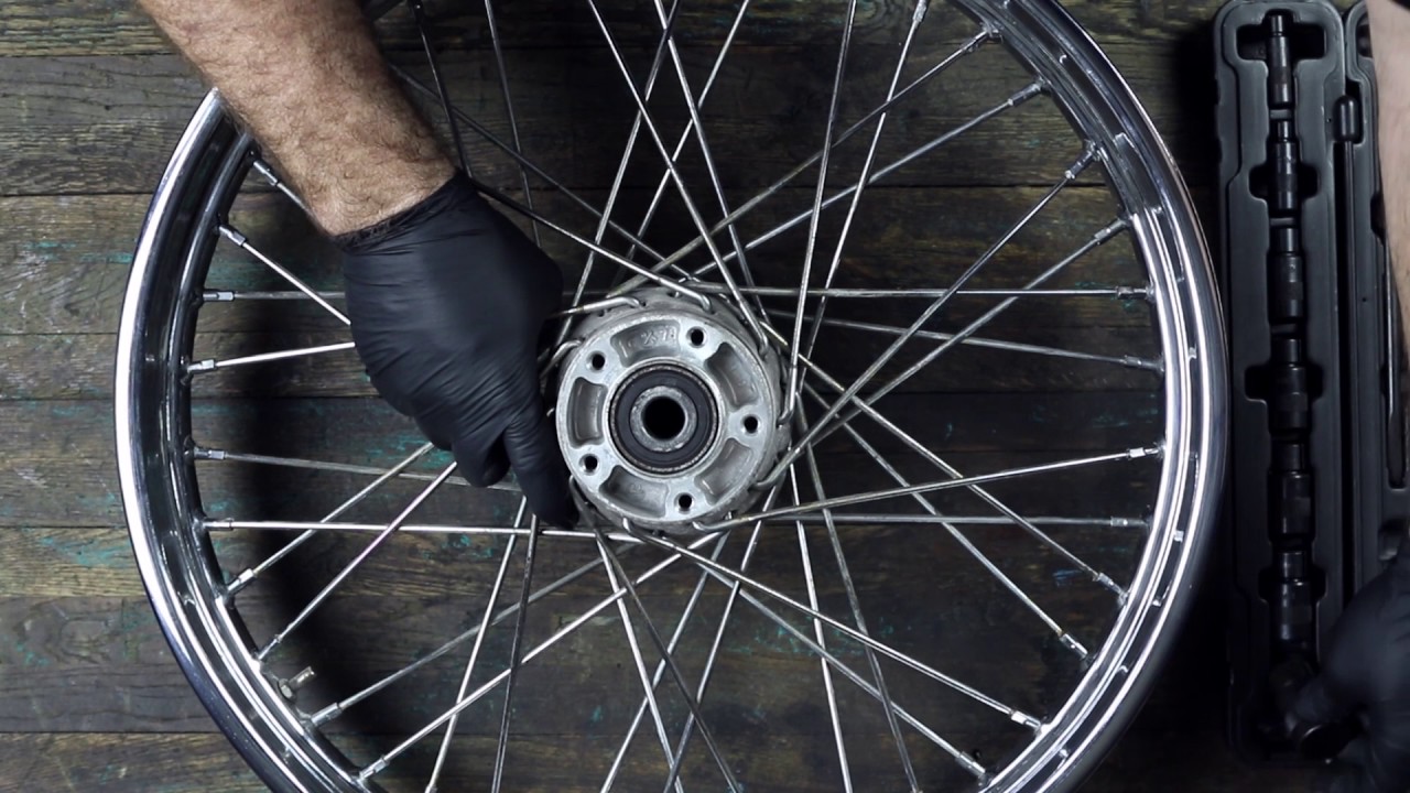

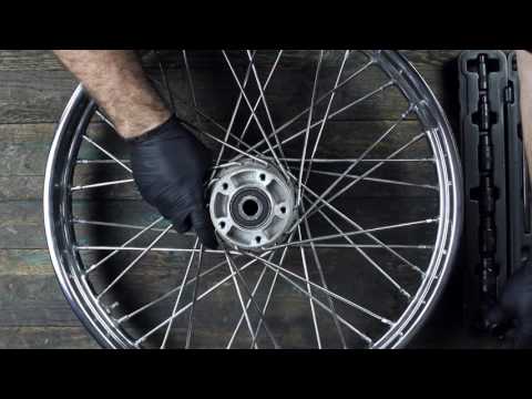

          There are tools that handle this chore with ease. One is made by 'Pit Posse' -- haven't heard of them lately though. You drop a slotted insert into the ID. It barely fits. You press a wedge into the insert's slot, and drive than in a little with a hammer, which spreads the insert apart just a little, enough to grab the bearing's ID tightly. Then you just smack the insert, and out comes your bearing.

                    I have one of these and it works great. Definitely worth the cost if you plan on tinkering on old bikes.

                        https://www.amazon.com/Pit-Posse-PP1...dp/B004MAPN42/
                        Just watched the video. Definitely a neato tool worth having.
