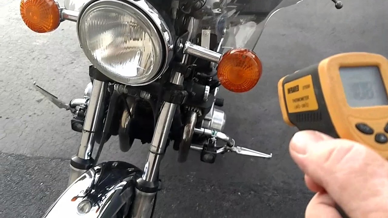

    What's a good good engine temp for a 79 GS550? Put my IR thermometer on it after a ride (in 35f) and the engine temp was reading about 220-240f on the head. Exhaust header was about 240f at the head.
    I only ask because I feel like I may be running lean. Bike pulls through all RPM range without breaking up, sputtering, or popping. I have no rational reason for thinking this - just a sneaking suspicion. Stock airbox and jetting but it does have a 4-1 header (MAC). The header is blued around the exhaust ports for about 6-8"" or so.

          that plug does look lean but there is lots of info online and Many shop manuals have pictures too-(is it the Clymers' have this? one of em anyways) the pipes tempering to blue seems an indicator too. You can richen up your idle-mix, double check the correct heat range of plug, etc etc. Maybe the pipes themselves have an effect?
          As to the IR thermometer, they are fun but I don't exactly understand them when a few degrees is important... Different materials have different emisssivity..shiny exhaust pipes, alluminum and so forth
          google search "IR thermometer and emisssivity"
