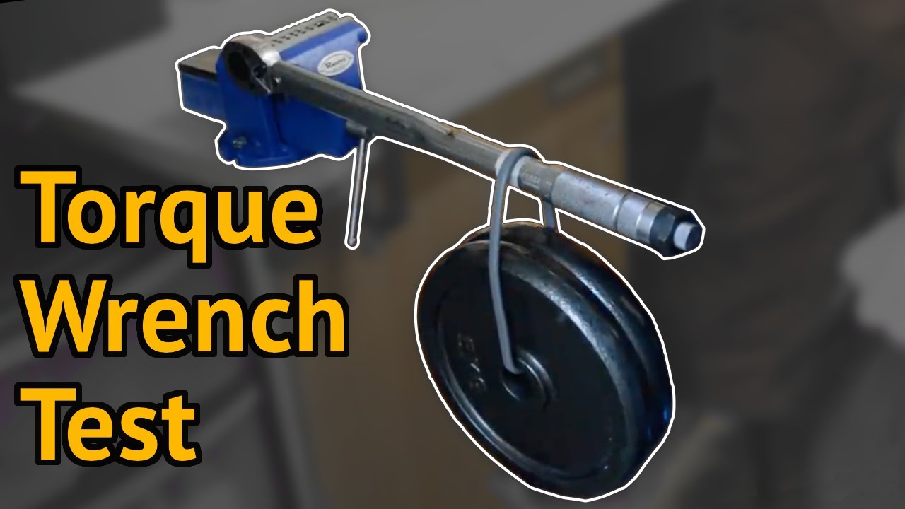

              What was shocking was that the bolts would twist with little effort. It is possible that the head had been heli coiled but I was doing everything with an HF calibrated torque wrench.
              I did a thread on torque wrench calibration long ago, but it doesn't come up in a search. I found this instead.
