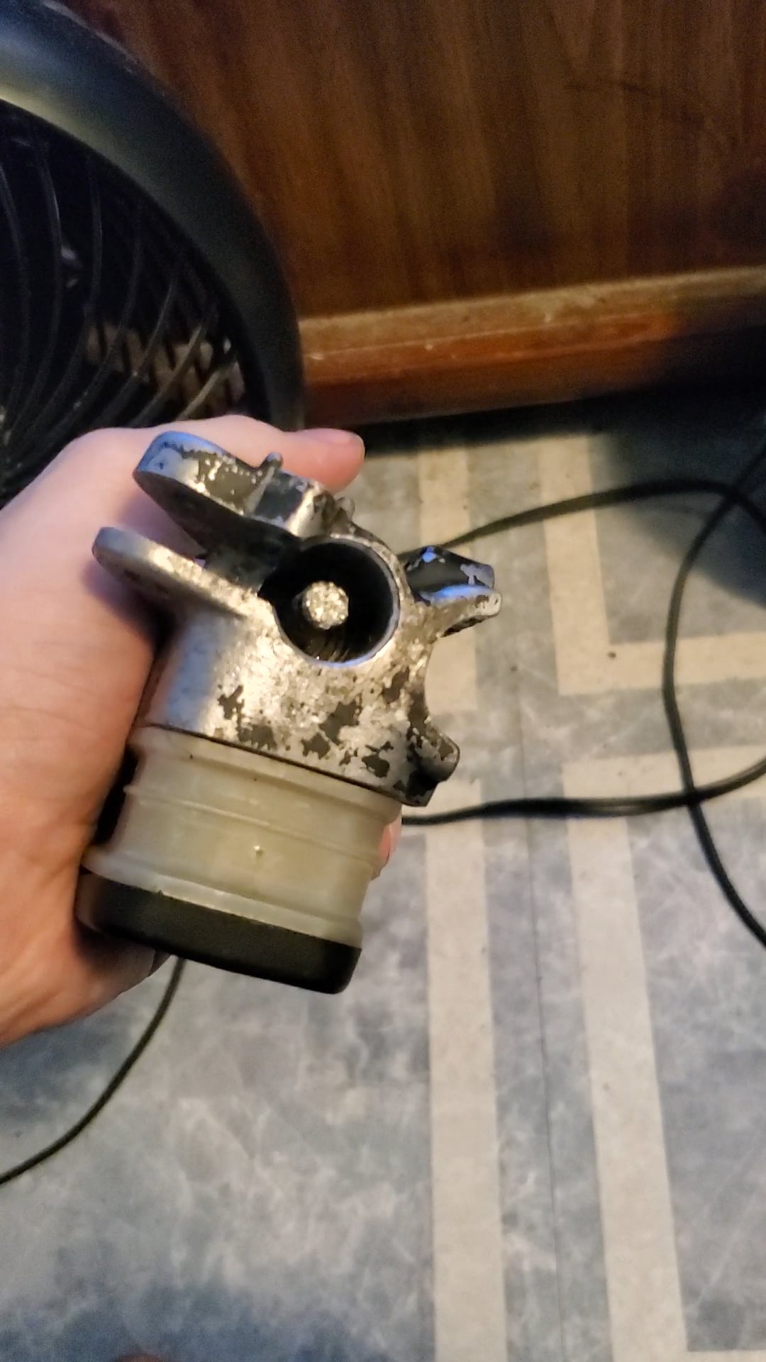

    I got the piston in the front brake master cylinder to move, and I can hear air moving through the hole where the brake hose goes. However, when I hooked it to the hose, filled it with fluid and pumped the handle, nothing came out. A few air bubbles come up. I took the screw out and pumped the handle again, but no fluid came out of the hole.
    I have not been able to remove the piston.

      Here it is with the circlip, washer, and gasket removed. I haven't been able to get the piston out.15786190122846623654847335597287.jpg

          That's the thing... the piston won't come out.

            Keep your patience. Gently keep gripping it with pliers...it does loosen up...but the rubber is suctioning it.
            It will eventually come out.

              It sounds like there's a piece of metal inside stopping it from coming out. Did Suzuki make master cylinders that couldn't be opened?
                Here's me trying to remove the piston.

                  That piece of rubber around the Piston is part of the problem...it's suctioning the Piston from being removed.
                  I kept at it for a couple of days while the other pieces were soaking in solvent. Eventually, it popped out.
                  I had to learn patience. Just keep gently pulling at it...you are dislodging it gradually.

                      The circlip is removed...he's having issues pulling the Piston out.
                      It's wedged in there tight because the rubber seal around the Piston must travel upward and out of the chamber.
                      It takes time because of the suction the rubber is causing because it's been in there (probably) since the bike was built.

                        might try removing the the reservoir and getting some penetrating oil (PB blaster?) in at it through the holes in there. Also let some PB sit on top of the plunger for a couple of days.
                          I just watched the video OP posted and yes! The reservoir cap/lid needs to come off to let air flow through those tiny vents in the Master Cylinder.
