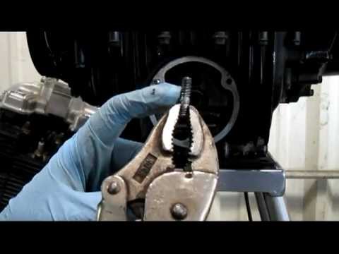

                  Just to help you with the proper names for the fittings you are having trouble with: the rounded nut that you remove with a 10 mm spanner is called an "acorn nut" because of its shape. The acorn nut screws onto a threaded "stud", which turns into the engine case. A "bolt" is a threaded fastener that has its own "head" onto which a spanner fits.
                  You remove that third stud by clamping a "vice-grip" pliers onto it and turning it a small way anti-clockwise, then a small way clockwise again, and continue small anti-clockwise and clockwise movements until it is turned out all the way. The reason for the small back-and-forth movements is to prevent damage to the threads in the engine case. Do NOT turn the stud further in ("torque it until it gives")!
                  Usually the outermost threads of the studs, where the acorn nuts screw on, get damaged from over-tightening the nuts - the other end of the studs where they screw into the engine case are usually not damaged. Just replace all three studs and acorn nuts with OEM parts. Use Loctite on the threaded part that screws into the engine case, and not on the outer part where the acorn nuts screw onto. To turn the studs into the engine case, put two "normal" nuts (not the acorn type) onto the outer part of the stud and tighten them against each other using two 10 mm spanners, and then turn on the outer nut to thread the stud into the engine case.
                  I am not sure if the other two studs on your bike are stripped just on the outside where the nut goes, or if the threads in the engine case are stripped. If so, a helicoil will be needed, but do not go oversize, because there is not much material around the threaded holes in the engine case.
                  Years ago, I stripped the outer threads of two of the three studs because I always tightened the filter cover against the spring pressure of the filter cover without first pushing the cover against the engine case with my other hand, because the exhausts were hot. Lesson learned, so now I do not get the engine so burning hot before an oil change, and use a glove on my other hand to push the cover against the engine case, so that I can screw the acorn nuts on mostly by hand. Finally tighten bit by bit with a spanner. It is only a 6mm fastener, and does not have to be gorilla tight.

                    Do you use the vice grip pliers head on, or at a 90 degree angle?
                    So if I understand this correctly, one nut on each end of the outter half, and then turn the nut furtherest away from the engine block? Both on the outside "half" of the stud? How do I get the inner (closest to engine) off?

                      I came across this nice video, it may help a bit in choosing
                      your way to approach the repair.

                        The "double nut" method mentioned should be the first try,
                        if there's enough thread for 2 nuts to grab the stud.
                        The methods shown in the video are next.
                        The people on GSR will be there to advice on which method is best depending on what the studs or leftovers of the studs require.
                        The movie will help you understand their advice.

                          When you get new studs for the oil filter, note that there is a non-threaded portion near the center.
                          Put the shorter end into the engine, leaving the longer end to hold the cover on.
