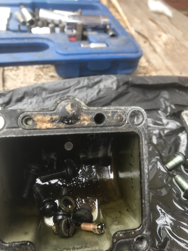

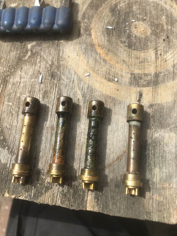

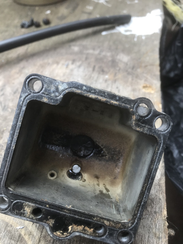

      This is what happens to carbs when you don't drain the fuel from them and leave them for 14 years.

            Yes. I know they will clean up with an ultrasonic cleaner and a small cost for new seals but if I had put it away properly then none of this would have happened and the bike would have been running fine.
