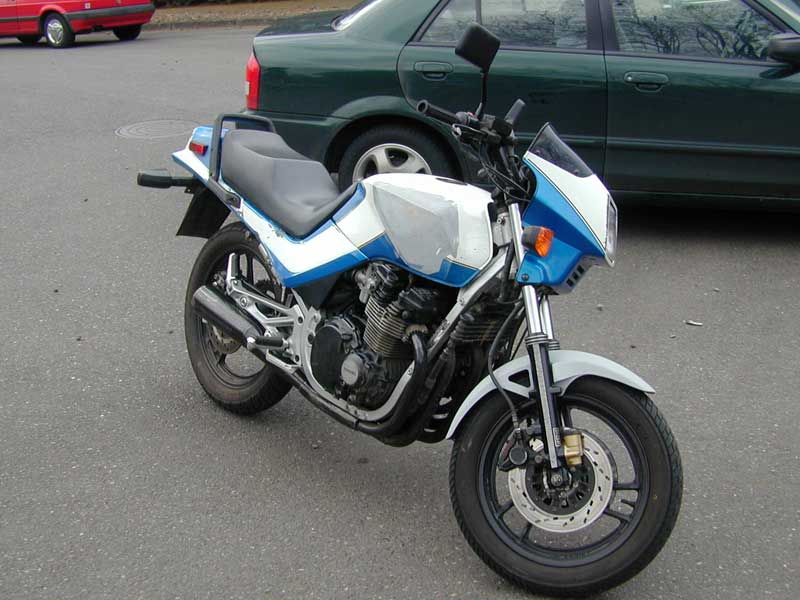

    Hey guys I have a 83' Suzuki gs550e, here is a picture for reference http://www.borked.us/albums/GS550E/84GS550E_5.jpg
    Anyways, I'm having a problem with the electrical system, basically everything was fine until I laid the bike down pretty hard. First off the battery wouldn't stay charged so I bought a new battery.
    Then the new battery wouldn't stay charged, so I decided to just trickle charge it every night. Then all of a sudden the headlight and turn signal solinoid both went out.
    Bought new ones of those and everything was fine for a week now the brand new headlight and the solenoid burnt out a week later, and the battery still won't charge on it's own.
    I'm so confused...I don't know anything really about the electircals on my bike, but could it be some sort of voltage regulator issue?
