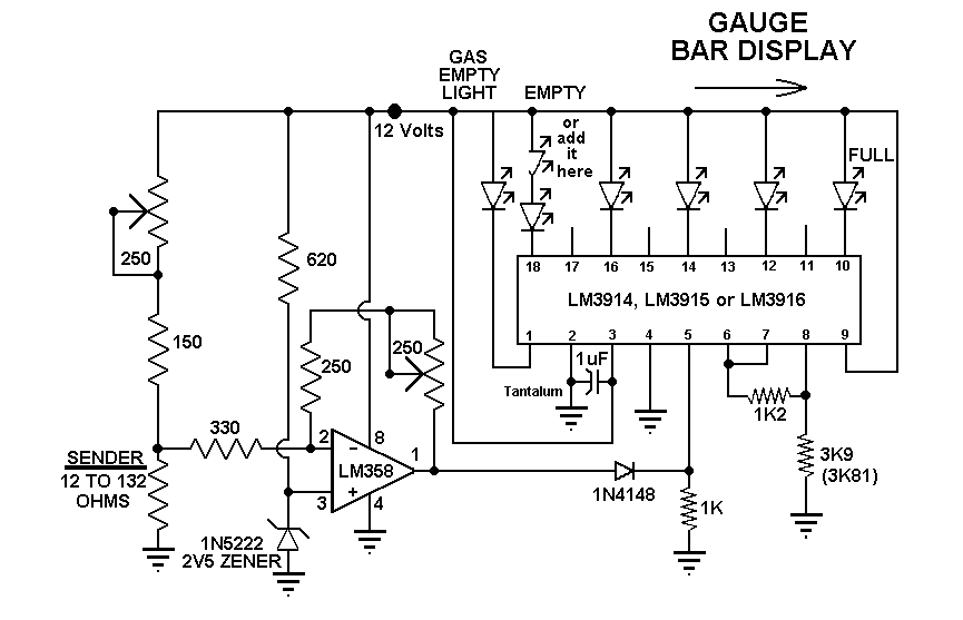

    1982 GS1100G LED Fuel Gauge Project:
    Foreward: the resistances and such represented here are specific to ranges my tank sending unit read out to, however, if you aren't looking for a very accurate fuel gauge, but rather, a tool to decide when to stop for gas, this should work for any sending unit that reads between 1-130ohms. mine read 2 at empty, but i decided to go with 12, as that would give me a little leway.
    plus, there is a spot where something goes, so i figure, put something shiny in there.
    Prep: I searched the internet, and stumbled on a website http://www.electro-tech-online.com .. they have TONS of schematics and people who are knowledgeable about electronics in general. they are like.. the gsresources of bread boards
    having searched their site for a digital fuel gauge schematic, i came across this: http://www.electro-tech-online.com/e...ght=fuel+gauge
    (page 5 has the schematic i am using)
    hmm.. looks like what i need, it has the right resistance ranges.. it's cheap and already laid out. "I'll take it!"
    (note, i am not responsible for designing this, nor am i guarenteeing it's functionality or safety. use at your own risk)

    My shopping list, at this point looks like this:
    LM 3914 LED controller
    LM 358 low op amp
    Resistors:
    1/2 watt: 380,330ohms
    1/4 watt: 510,680,1.2,3.9k ohms
    6-10 single bulb LEDs OR 10 LED Bar display
    board to solder to

    Originally posted by seuadr
    this model, from looking at the OEM diagrams had a small gas guage.
    the gauge itself is discontinued according to suzuki, but i had a thought:
    since float guages are pretty much just a measurement of resistance.. what about getting the correct resister range for led bulbs and using those? anyone try this? i know the ready made moduals are pretty expensive, where as buying a control board and the bulbs and resistors myself seems to be pretty damn affordable.
    thoughts?
    Go for it. Post your results. Be the pioneer.

        Yah, you could design something to setup a voltage divider with the differeing resistance of the sensor and then trigger different LEDs at the different voltages levels.
        ... Or you could find a replacement gauge cluster on ebay....
        ... Or you could do like what most other riders do on most other bikes that dont have gas guages and use the trip odometer and the reserve tank of the petcock.

              update:
              i did a little searching about the web, and found out alot of information about LED's and how fuel sending units work. I also learned that mechanical fuel gauges are basically relays.. with multiple coils to pull the needle :shock:. never knew that!
              i found a fantastic diagram for exactly what i want to do, with a very, very similar range to the resistance ( my tank was reading between 10 and 120 ohms )
              found a local supply shop here in lansing, the gentleman that helped me was fantastic in finding a similar replacement out of the brands they carry. so far, i've invested a few hours of research, and 14 dollars for parts. i still need to get all the resistors and the zener, as well as whatever system i am going to use for the led bulbs. I've got a few options, i could run a 10 place bar graph, which could be set linear, or as dots to display, or i could make my own mount for individual LED bulbs. haven't decided yet

                            Here is a bar graph array.
                            For such little money I think it's really worth it, especially considering the time saved by not having to mount 10 seperate LED's not to mention the real estate taken up by 10 seperate LED's. I'll see what I can scrounge up at work compnent-wise and put this item on the project list. Gotta get the bike back on the road ASAP tho and I already have a functional gauge.
                            • seuadr
                              aye, i was looking for something like that, but the local shack didn't have any led's at all >< that bar display is actually what the second 20 pin chip was designed to drive.
