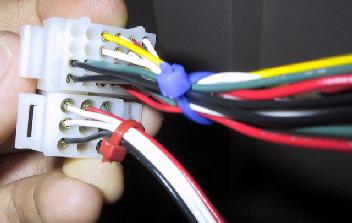

    Does anyone know a part number/ supplier for the R/R mating connector. I need to replace mine on a 82 gs1100gl.

    Hi Mr. eddiev,
    I'd recommend replacing both connectors. You can pretty much use any matched pair of Molex connectors with crimped pins. Just pick up a male/female set, with the proper number of connectors, at a local electronics store. They come in 1x2, 1x4, 2x3, 2x6, 4x6, etc, all kinds of combinations. Examples:
    I've replaced most of the connections that I've worked on with blade connectors, where the bulk wasn't an issue. You might need wire strippers and a crimping tool too.
    BassCliff

      Thanks. I actually picked up a 4 pin connector that's used to wire a trailer. I'm not sure if I'll use it or not. the stock plug fits nicely into the square notch so I was hoping to get the same. It seems to be a standard plug.
