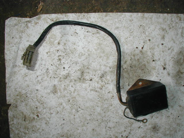

                • lifguardct
                  I also have one but its from a 81 GS1100, see pic.
                  • glstine
                    According to my reference software the 80-81 GS250, 450 and 550, and the 82 450 used the same igniter.
