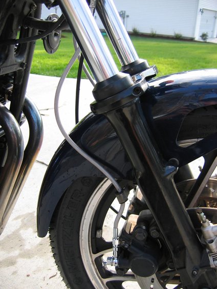

      BTW I have a bunch of the bolts you need, so you can cap off the hole where the brake banjo bolt goes, it's a m10 1.0 pitch i believe it's about 15mm long or less.
      I can sell folks some, since i had to buy a bunch to get 2. I'll make it cheap say 3 bucks with shipping.
      Originally posted by AOD
      You don't need the block-off plate if you find a threaded bolt that fits in where the banjo bolt used to go. I had to use a cut-off wheel to trim the bolt down to where it fully seated in the anti-dive body.
      Use the single banjo bolt from the anti-dive body to replace the double banjo bolt on the brake caliper. They're the same size, so it's really really easy.
      When asked why should one remove it...it's not needed if you use Progressive fork springs to firm up the front end.
      ~Adam
      78 GS1000 Yosh replica racer project, 82 Kat 1000, 10 990 ADV-R, Some dirt bikes

              here is my new set up,anti dive disconnected from brake lines but manually adjustable if required.
              1978 GS1085.
              • tkent02
                • Jan 2006
                • 35571
                • Near South Park
                Does this function as a compression damping adjustment?

                    • pjm204
                      I put a bolt in mine but it is coming out from where the original banjo bolt was. I like the way yours looks a lot better though. Those spikes look incredible.
                        nice mod! I want to upgrade to s/s lines and dis-connect the anti-dive. Looking into what to do. I read on here about using a bandit 1200 kit. any thoughts on this.
                        How has this set up worked out for you thus far. Have you been playing the with dampening via the valve? Also, are you runnin (dual) s/s braids?
                          ie only got one disc/ caliper. i have adjusted he antidive so it is full on. seems to work the best for my liking
                          1978 GS1085.
                            • 35810
                            It's not exactly "antidive" that is "full on", you have increased the compression damping on the fork. Doing this will reduce suspension compliance and make the ride quality rough.
                              but it works for me, i can reduce it if i want but thats how i like it, as so many people have said i doesnt really work anyway so i have found a setting that works just fine for me
