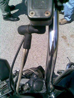

    Now the weather's finally cleared up I've been able to ride and test out my new brake lines and they feel great - really solid and firm. While installing the brake lines i put an electrosport hydraulic brake switch as the banjo bolt at the MC.
    I'm having a slight problem however - the brakes grab before the light comes on! If I grab the lever to come to a stop its not a problem, but if I'm just slowing down then there isnt enough pressure for the switch to activate...
    Is it a problem with the switch you think, or my installation/bleeding?
    Oh, and here's a couple of pics... just because:

        switch is not compatible with your application, not a fault with the lines.
        those switches require a set amount of pressure to trigger them but on the GS it does not take much pressure to give reasonable braking with good pads.
        you need a switch with a lower trigger pressure.
        this is why Suzuki went with slide switches.

            is there not a pressure regulator adjuster on the switch? usually fitted on the top between the 2 electrical connectors
            1978 GS1085.
            • iDodgimus
              um... you mean at the blue part in my pic?
              nope, the two wires disappear into the plastic and the whole end is covered up with some kind of epoxy sealant.
