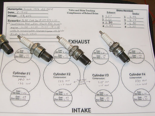

    I just recently completed a Valve Shim job. Prior to starting the shim job the bike ran very well (idled at 1500, no hesitation and very easy to make 80+mph, very little smoke on startup, very easy start with full choke followed by full off choke and down the road in 45 secs)
    So I completed replacing the shims and got the valves within spec. and now it acts as though the carbs are out of sync. It won't idle below 2k, stalls at the light, boggs down on the smallest hill, boggs down really bad if I try to Throttle hard.
    -Shim Clearances between .04 to .09
    -Carbs are Precisely synced.
    -Compression well within spec 115-140.

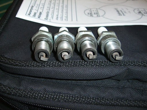

    -Plugs are burning clean unless I idle too long in the garage.

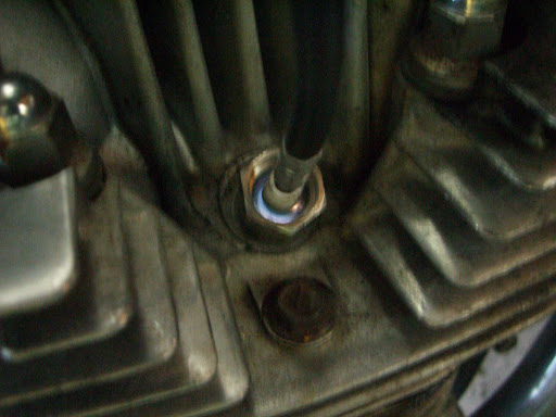

    -I adjust the Air Screw near 2.5 turns for best running unfortunately I do not get a clean blue flame using my Color Tune. Looking at the Air Screws they look in perfect condition.
    I am open for positive suggestions on what might be going on.

          When using your colortune, you need to be adjusting the fuel screws, not the air screws.

              I did do the carb sync and the compressions tests after I finished with the shims.
              Air Screws = fuel/air mixture screws each are approximately 2.5-2.75 turns out from full tight.
              Yes, .04-.09mm was the range.
              Ex.....Orig......Final.....Gap
              1.......2.50.....2.57......04mm
              2.......2.60.....2.63......07mm
              3.......2.60.....2.70......04mm
              4.......2.65.....2.63......08mm
              In.....Orig......Final.....Gap
              1......2.55.....2.02......04mm
              2......2.70.....2.75......04mm
              3......2.80.....2.90......04mm
              4......2.70.....2.70......04mm
              Compression
              Cyl....Cold.....Hot
              1......136......140
              2......117......122 (Prob. higher as I couldn't get wrench on fitting)
              3......115......115 (Prob. higher as I couldn't get wrench on fitting)
              4......120......130

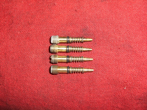

                          I never knew about that fuel screw that you guys are describing. I just went and looked and I think I see the one are describing. It is at the bottom of the carb and is not attached to the float bowl. I have never adjusted those screws before.
                          • tkent02
                            • Jan 2006
                            • 35571
                            • Near South Park
                            Go careful here!
                            If you bottom those screws they will stick in the hole, the tips break off very easily, they are very long thin points.
                            Find a very short screwdriver that fits tight in the slot, see if they turn freely. It's not easy to get the inner two even if you do know how the screws work. Most are at least a little bit stuck from age unless they have been taken out already, some still have a spot of paint on the threads from the manufacturer's attempt at making us not be able adjust the carbs.
                            If they are it's probably best to pull the carbs so you can see what you are doing, put the carbs upside down so the screws are right side up. Get them free and turning easily, only then is it safe to try to bottom the screws lightly so you can count the turns out. Once you break off the tip in it's tiny port you have a much bigger project on your hands.
