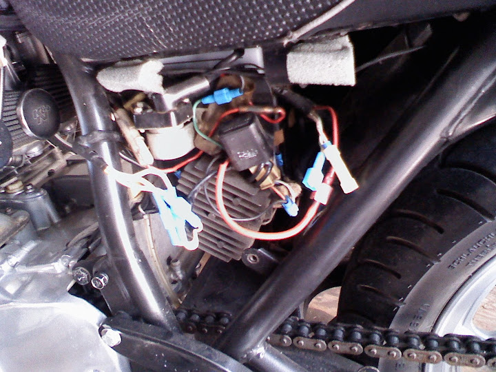

    Anyway, here how the RR wiring looks at moment:

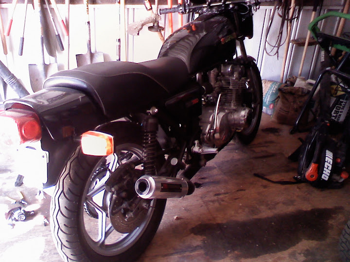

    Well I guess it is time to give 'ol Suz a good once over all over again. Here are 2 crappy pics in the shed in case anyone cares. Cramped, lighting was bad, she's dirty as hell and I didn't want to pull her out and disrupt the diagnostic "massage" that is going on.

        this is my bike. thx to basscliff, I get how to attach pix now. very nice of you to get my back on this post....

              BassCliff - thx for patience and advice. I will be starting the mega wire cleaning deal tomorrow. Today I tried to address the power wire. I don't think my bike HAS a fusebox. If it does, where is it? (review pics u helped with below). It looks like just one main fuse to me.
              Anyway, back to RR pos wire. I am planning on a deeper diagnostic later this afternoon, but as of this a.m. I cannot tell where the heck that RR pos goes and/or how the heck it is getting to battery! It almost looks like it is tied into a wire that goes up to front of bike (to switches? can't tell yet). Not sure if relevant, but I see no "sense" wire from RR, so must be a 5 wire then? Can POS as wired have anythign to do with not have a sense wire? My guess at moment is my old mechanic wired RR pos to swiched pos wire since there is no sense wire.
              BTW, so how does the RR "sense" load then w/o a sense wire?
              Bottom line right now is that I am too scared to rewire RR pos. Should I be? What bad things can happen if any?

                  Important CORRECTION: RR is SIX (6) wire. Black wire is scotchlocked (connected) into ORANGE. Orange and looks like a white or greenish white wires both go into the little black cube relay looking thing in the pic below.
                  Wiring diagram (BassCliff's site, etc) says RR black should tap into Orange and orange goes into fuse box. But again, I see no fusebox.
                  Can it possibly be that the sense wire is wired incorrectly? How to test?
                  Can I safely rewire RR RedPOS+ directly to battery (well I guess I can certainly try it, I do have fused wire loop handy rated for 30A, so 15 should be fine I'm thinking, if not, I can put back way it is now)

                      i don't know that that there is any test for the stator current output under load, but as i am positive i have a good battery and wiring and RR, and the stator looks suspicious, i ordered a new one.
                      taking the stator out IS really easy, put the bike on the centre stand, put the screwdriver through the centrestand to lock it (there is hole there to do so) and put a 2x4 piece of framing wood under the front wheel. the bike is safe and FAR from tipping over but the cover can be taken off without any oil spillage. i tried it myself just the other day.
                      the sense wire is correctly wired into the orange wire.
                      don't worry about the fusebox for now (it may likely be a single-fuse model that you have).
                      just take the RR + wire directly to the batt through an inline fuse. if this doesn't correct the problem you can go back to the way it is wired from the factory - so it goes to the main fuse. this is a good enough setup if all the connections are clean and the wires are good.

                        pretty sure what i have IS a single main fuse model. so the more i think (it's getting harder and harder as i age) about it, there should not be any problem adding another fused hot direct to battery....should pose 0 harm (and to ur point, I can always put it back). I just wish I could tell what the heck the RR hot is plugged into now. But if no matter, then no matter.
                          usually, the RR is wired into the fuse (box)
                          with a bit of patience you can trace the wire from the RR and see where it goes

                              It sounds like the output of your RR goes to the key switch and then the power gets fed out from there. You might want to take a look at the ignition switch. Try spraying some contact cleaner down inside and work the key back and forth see if that helps. You can take them apart and clean them and check the plug at the bottom and see how that looks.

                                3. Lucabond/psyguy/basscliff et.al: No fuse box. Single main 15A fuse. I have no idea where the RR +POS went to (and back), but went ahead and wired in a direct RR POS to battery, fired it up, and tested to see what worked/what didn't. Everything works w/o this connection, so I guess I'll be not using/taping up 3 wires not just 2 as per BassCliff's deal.
                                here are results:
                                Before RR POS+ direct to battery:
                                Lights OFF: 13.2v idle / 14.0 @ 5k rpm
                                Lights ON: 12.6 idle / 12.9 @ 5k rpm
                                After RR POS+ wired direct to battery:
                                Lights OFF: 13.7v idle / 14.9 - 15.0 at times @ 5k rpm. PROBLEM HERE?
                                Lights ON: 12.6 idle / 13.3 @ 5k rpm (small but real improvement)
