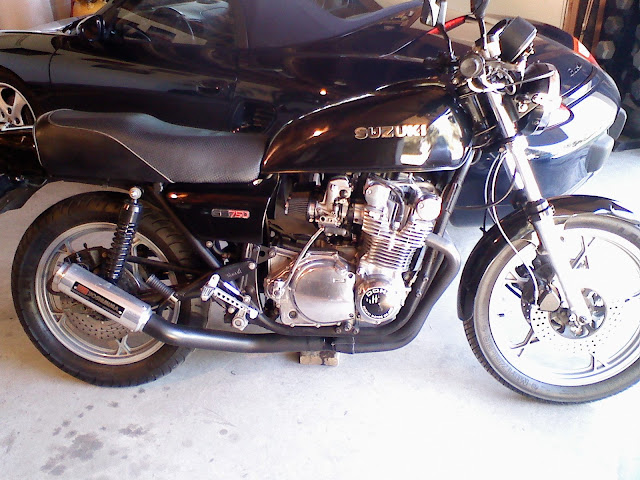

    They do the trick on warm engines. Warm as in phycially and as in modded engines. And there is always the WOW (wank) factor.
    Sharpy Engine looks great and spotless; Nice touch with the Yoshi sticker up front.

      • sharpy
        That Yoshi sticker has been on there since 81, too afraid to pull it off now lol And thanks
          Your whole bike is WOW worthy!
          Tony.
          • oshanac
            SHARPY- I had to save your picture on my computer. That thing looks gorgeous!!!
