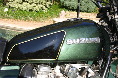

            • LarryA_Texas
              pin stripes
              I found that the Sherwin-Williams automotive paint store has a catalog of pinstripes in colors, double, single, two color, three color...almost any combination you can imagine. They go on like the OE decals and you clear coat over them. The more exotic ones are special order but they have an amazing selection.
              The stripes on my GS1000 are pinstripe, on my GS1100G are painted on. For the look and the work involved the pinstripes are the way to go.
              (maybe any auto paint store has them, but that's who I deal with for now)
