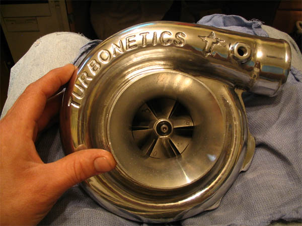

lecroy
On my screen it almost looks like it has a gold plateing on it. I would keep that one for my dinner table center piece.Comment

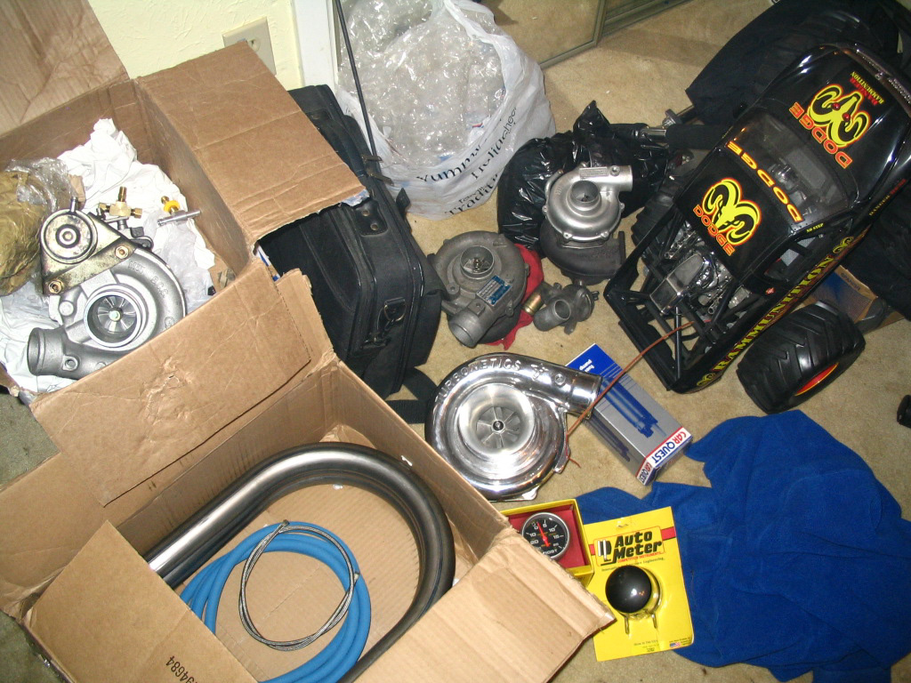

Marco I got a screaming deal on the turbo, could NOT pass it up.
The gold look is the reflection off the ceiling fan globes...
Did not use flash..
but here's a shot of the stuff laying around this room...
the big one in the middle is the gold tinted one a few posts back..

LOL!! Well, it's 20 years old and so is the bike!!Originally posted by Busafied..it has been overcome and the info on how is readily available now.
Four turbos?? What are you trying to do?? Put a turbo on everything you own with a motor???Comment

LeCroy it wasn't a jab..
I know how old the bikes are I have one too remember?
I was just saying the blowthrough pressure issues have been overcome.
as far as the turbos yea I have alot more then those, and yes I am probably going to do all the other bikes also.
Boost is addictive ya know?!
8)
