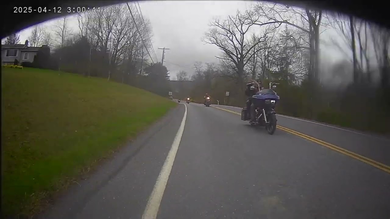

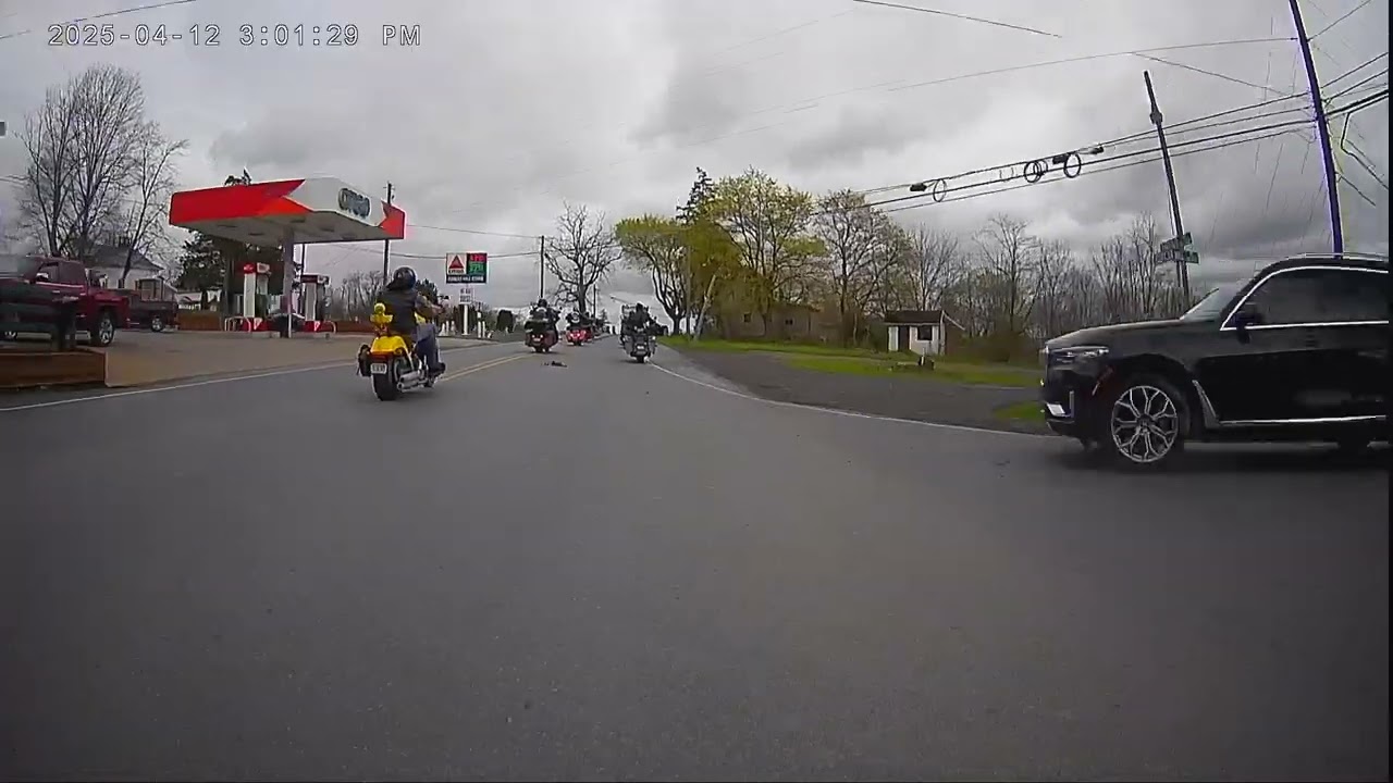

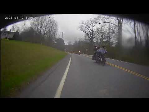

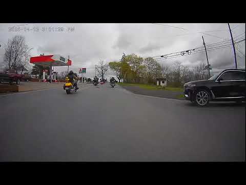

    Camera quality isn’t great for stills or video. But I knew that. GoPros they are not.
    But they’re better than nothing.
    I just finished the install yesterday morning in time for a planned benefit group ride. My first. Not the point of this post but pics and videos below are from that ride.
    front camera still:
    rear camera still (vignetting from rail rack):
    front cameras video:
    rear camera video (same scene):
