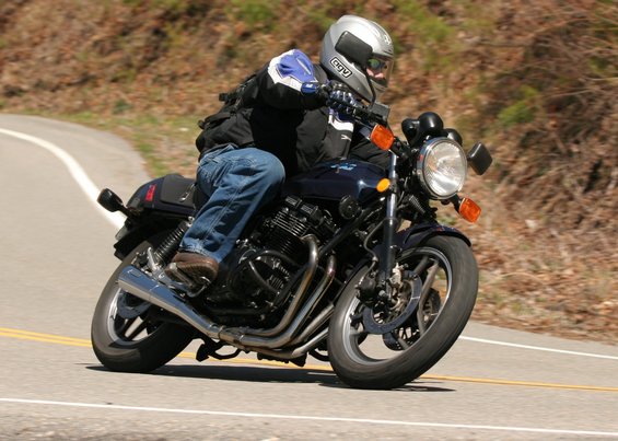

                            I own a pair of those Konis as well. They are OK but get a little inconsistent once ridden really hard. The Vipex pieces offer a far better cornering dynamic - I will guarentee that. On two other notes - that Kat of yours is a nice piece. You are only a few hrs down the Highway from me (ok - 6) If you ever ride to Toronto send me a PM.

                              let me return the compliment on that killer CB-F of yours
