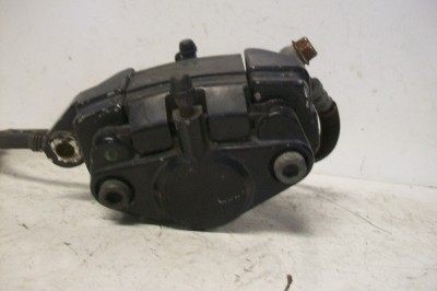

                I just ebay'd a 2006 GS500 caliper that I believe will fit directly onto my 77 GS750 caliper hanger bracket. 89-2010 GS500 calipers are the exact same caliper as the 83-86 GS550E, which most likely would interchange with our older bigger bikes I assume, so I am guessing that this caliper is a direct bolt on. up to 2002 looked like this:
                and 2003-2010 GS500 calipers look like copies of those with a not as smooth casting and a different name on the end, exact same shape though.
                This is the early & mid 1980's caliper (try GS650 in the search, this came on those and other GS's) that is an improvement on the older very bulky style:
                and this bulky dinosaur is what came stock on our bigger older GS's, note line connection comes out rear at angle, different configuration than the two above, and much wider (longer) front to rear than the two lighter versions:

                  #68

                    Well for $20 for a 6 year old caliper from a bike with 1,024 miles, I figured I'd be the guinea pig

                          Well, the second gen version of the GS500 caliper ('02 or '03 to 2010) arrived today, same diameter pistons, all mounting specs match up with the big Tokico GS1100E caliper that I have sitting here (came with my 81-83 GS1100E swing arm) EXCEPT that the mounting bolts are smaller diameter and are 75mm center distance, the big caliper is 80mm.
                          I suspect that the GS650 type smaller Tokico caliper is probably the 75mm spacing, but looking for someone to confirm. Ebay photos seem to indicate to my eyes that the GS650 caliper brackets have the smaller bolt diameter as the GS500 caliper, so I think I am on to something.
                          If anyone else (Pat?) could measure the GS650 type caliper mounting bolt spacing, that would be awesome, as the winter just hit us hard today and the GS650G is outside at the local VJMC junkyard if they still have it (I stripped half the bike down months ago).
