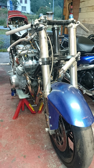

                Here's the conversion bearings and new swingarm bearings pluss fork seals and dust collars
                mounted
                Changing the fork seals ment I had to make myself a new tool for compressing the spring... A piece of exhaust pipe, two nuts, some self vulcanizing tape and threaded bar and voila:
                a friend of mine came through and made me some new collars and bushings for the rear swingarm, the swingarm was also milled down 3 mm on each side to fit inside the gs frame...
                So now the only stuff that remains to get it rolling is to remove the battery tray and make the mounts for the upper and lower shock and brace the frame, however its sort of on hold at the moment because the rear tire is a 190/55-17, way to big. My thought is to use a supermotard 4.5" wheel with a 170 rear tire. Also a supermotard front wheel with gsxr spoke hub from cognito moto...
                I'll probably be picking up a set of SM wheels next weekend so I can start the job of fitting the rear wheel and get the geometry like I want it Stay tuned
