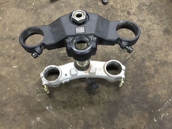

            I've done web searches for dogleg triples but can't find any info. Still don't understand how this improves things. Do you have a pic or a link for this? Thanks.
              CBR954 Triple clamps:
              Lots of people call them gull wing triples instead. The top triple isn't flat, the sides droop down so that you can slide the fork tubes further down and gain some of the lost length back.
              Mark

                • mcarroll_nz
                  Mark
                  Makes sense now. Thanks Mark.
