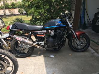

    this is was an 82 750E with a blown Motor ...... then some gsxrparts appeared cheaply then an 83 1100E parts bike and, well, I got carried away

      heres a a mock up of an 1127gsxr lump in a 750E
