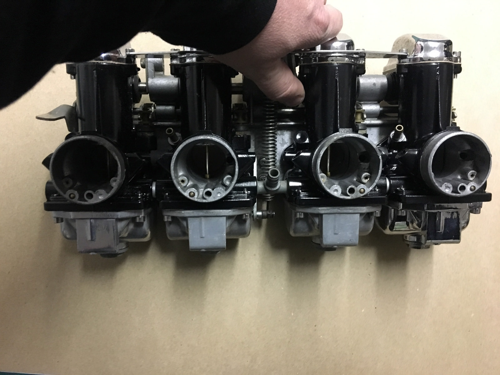

                      • 80s cars or gtfo
                        Originally posted by mmattockx
                        I have seen a number of people mention using the larger 1150 carbs on the 1100 engine. I am currently running pods and a Kerker 4-1 on my 1100E and it runs extremely well. For the people that have experience with this, does it provide a useful increase in power and (in your opinion) is it worth the effort to sort jetting and do it all again, considering I have mine running so well with the stock carbs? Another question that comes to mind is can I use the same APE pods on the 1150 carbs as I am using on my stock carbs? Having to buy a new set of pods significantly adds to the expense of the swap if it is necessary.
                        Thanks,
                        Mark
                        Hey, sorry to bring up such an old thread, but didn't want to make a whole post about this. When I bought my bike the PO gave me an extra set of mikuni carbs that he said we're "a common upgrade" that's all I know about them. Before installing them however I want to know if that's true and if so, what carbs they are. The carbs are somewhat larger than the stock ones so I think they may be just that. Can you upload a picture of yours or perhaps give me a part number or other way to identify them?
                          I don't have a set of 1150 carbs yet to post a picture of. You should post a picture in the carbs/exhaust forum and ask for identification help there. I am sure one of the veterans will know exactly what you have on your hands.
                          Mark
                          • bobgroger
                            • Jun 2013
                            • 2482
                            • Enumclaw, WA
                            1150 carbs have a stamped steel top cover with a dimple to hold the spring and the throat near the butterfly measures 36MM. They could also be VM smoothbores, they look totally different.
