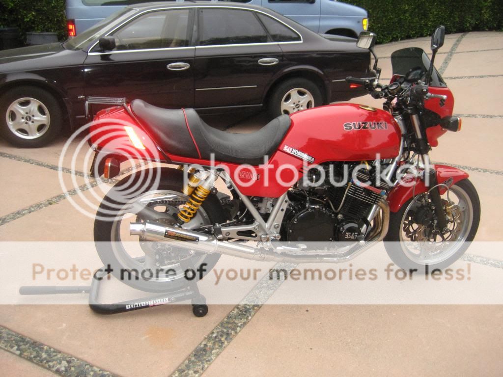

    1988 1st Gen GSXR 1100 wheels with 170 on the rear
