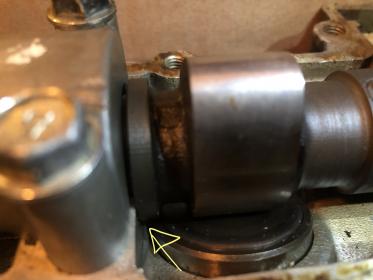

            On the subject of reducing the base circle, it also appears to me that it will be necessary to trim the rings cast into the cams that prevent the cams from travelling left to right in the head.
                    Why ? The buckets clear the thrust flanges by quite a margin. You're not touching the bearing surfaces or the cam caps. You won't need to cut away the bucket carrying area to clear cam lobes till you get to about .450in lift....

                            On the stock head and cam I have in front of me, the thrust flange (thank you for the name) is only about .050" away from the edge of the lifter (not the shim, but the lifter bucket itself) when the lifter is riding on the base circle. More than that can be removed from the base circle before the base circle is reduced to the diameter of the shaft part of the cam. I will try to post a pic.

                              Here is the best pic I can take. The yellow arrow points to the place where I believe interference would occur if the base circle becomes small enough. Unfortunately, the eye can see more than the camera can.
