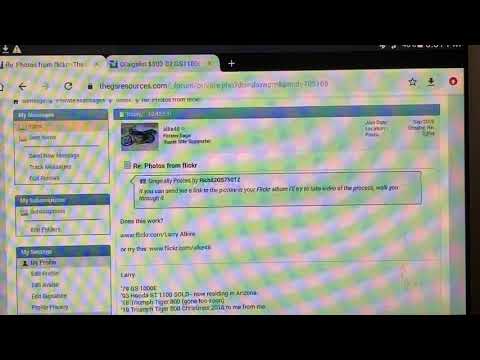

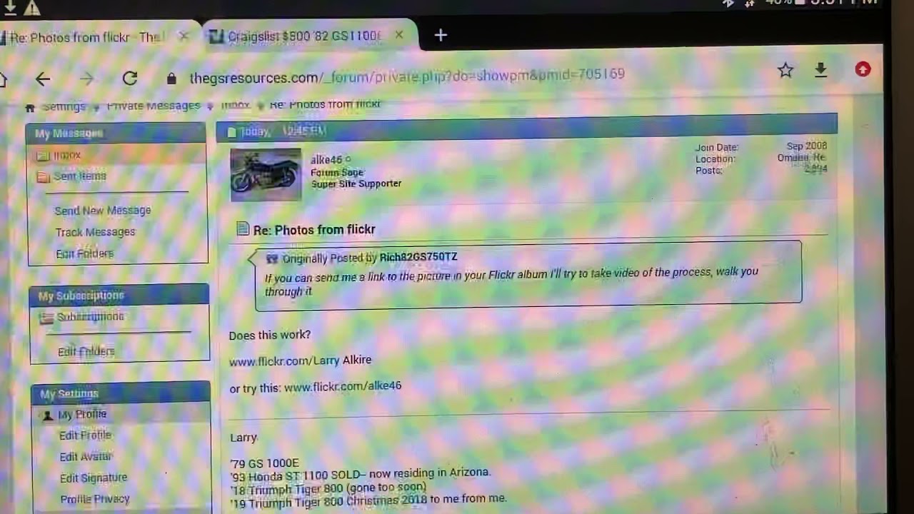

    As for posting pics from your Flickr account, you need the BBCode which you can’t get from the App.
    watch this (iPad/Safari):
    or this (Samsung/Android Chrome).
