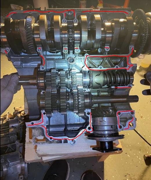

    If you haven't seen my new member question, I am now neck deep trying to restore this 1980 GS1000G. I have the engine out and the case split, I'm currently repairing the failed oil seals between the engine and the secondary gearbox. I've never split a case before and looking for advice on how to apply three bond sealer. Do I apply the sealer anywhere where metal will touch metal? See attached with "Red Lines"
    Thanks, looking for advice from anyone that has done this before

    Correct. Cover those surfaces entirely, even around the bolt holes. I've had engine case leaks where oil got into the bolt passage and then leak down under the bike. And be careful when tightening the screws. A torque wrench is good to use, set to the low end of the spec, but use feel too and stop tightening if you feel like the threads are on the verge of letting go. This is a common problem with 40 year old engine cases.
      Thank you Nessism!,
      So be generous with the Three bond and apply them everywhere as you stated above. Yes, I have to torque spec, but I believe the manual says to tighten the top first in ascending bolt order. That's a problem because I have the engine upside down. Also what happens if some of the three bond gets onto the "oil seals" where they may meet or touch, should I be concerned?

        "Generous" may not be the right word. The gap the sealant is filling is thousandths of a inch. If excessive sealer is applied most will squeeze out from the joint. If the excess falls off there is a small risk it could block an oil passage. I say small because the chunks are usually to big to pass the mesh strainer on the oil pump pick up
        Very thin but complete coverage might be a better description.

        I'm about to button up the cases of my 750, and will be going through the same process. One key thing is to make sure the mating surfaces are clean and grease/oil free prior to apply the sealant. I'm going to wipe all the surfaces with oil and grease remover before the sealer goes on.

          Lower crankcase screws first, then the uppers. The most critical are the 8 screws which hold the crank. Pretty sure those are first.

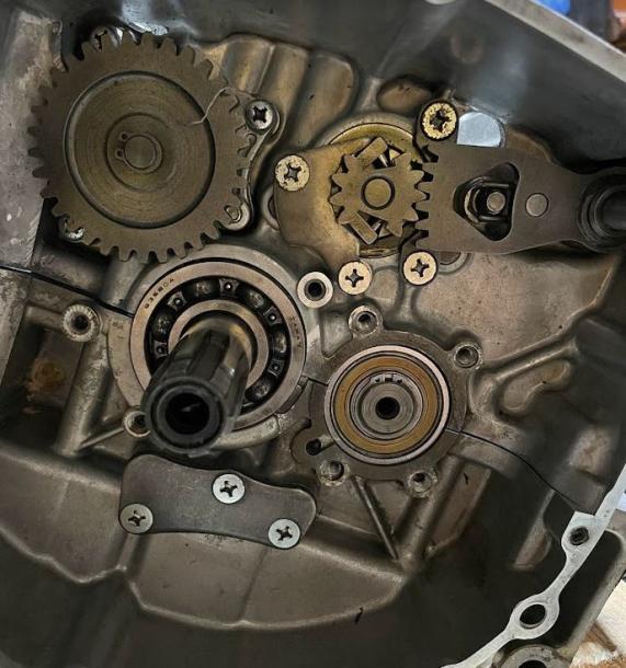

                      Guys, I am doing a dry run by placing the lower half of the case back onto the block/crank. After reading a few threads I thought I would make sure the shifting of the gears works now that I replaced the oil seals within the dog cam. The engine is presently in the upside-down position. The GS1000 was in neutral when I removed the engine. After a few wiggles, the forks slid into position and the case closed properly..
                      Everything was going great when the gearshift shaft decided to pop out of the teeth pawl holder. No Biggy right? But I don't know where it was positioned when it popped or what gear the bike was in.
                      • Does the bike need to be in neutral for reassembly?
                      • How do I make sure my shifter forks are all aligned and gears will work before I apply threebond?
                      • What are the major concerns here or am I freaking out over nothing?
                      • For reference, I never touched the shifter forks or the shifting cam
                      • Any tips or tricks?
                      I was planning on applying the three bond later tonight, but I'm concerned about the shifting of the gears before I close the case up.
                      Thank you in advance

                        one side has 5 teeth and the other has 4. The THIRD TOOTH on the one with 5 teeth goes in between the 2nd and third of the 4 tooth side. follow me??? so tthere will be 2 teeth on each side of the third tooth on the 5 tooth side. hold one hand up with 4 fingers and the other with all 5and interlock your fingers to simulate the pawls teeth. Youll get a visual i hope

                          line them up and post a pic and ill see if your good
                            Thank you! yes I read that alignment in the clymer manual. See attached pic of where it is now. I just wanted to make sure that if I reassemble this motor that the gearbox works and all 5 gear positions.
                            • If you are telling me it doesn't matter which gear you are in it only matters that the teeth line up and the forks are positioned within the gears... then I believe I am good.

                              The third tooth on the shifting drum should have the same teeth on each side of it. If your even then your good. If your off a tooth you can index the shifter lever later. Just put the bie on the center stand and put the clutch cover on withot a gasket and work the shifter while wiggling the rear wheel. If it goes good then put the gasket on and call it a day. If it hangs up move it 1 tooth and try it all again.
