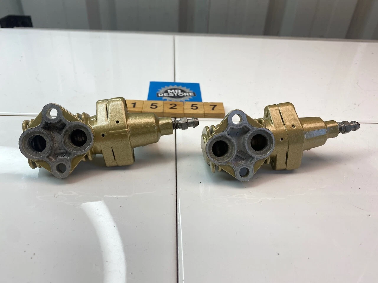

      In the mean time I noticed that the left fork had left a small spot on the floor. I think it has been doing this since I got it, but I was only now just noticing it.
      It appeared to be coming from the anti-dive unit, so I pulled up the diagram and found two O-rings that I could blame where it connects to the fork. Those I found dimensions for so I ordered a pack from McMaster-Carr for the price of a single O-ring from a dealer. I wasn't sure whether to go with Buna or Viton, but I doubt it really matters here. So I swapped the O-rings on both sides and refilled and repressurized the shocks. This was the first time I had to change fork oil and I was a little surprised by the color of the old oil. It was opaque, sort of a graphite grey like brake grease. I probably wouldn't have thought anything of it if I didn't have a record of the fork seals allegedly being changed only 3,000 or so miles ago which I would imagine meant new fork oil. Is it normal for oil to turn that color that quickly?
      Anyway, I took it for a drive and for a while it seemed like the leak had stopped. A couple drops still fell off both sides along the way, but I just attributed that to the leftover oil hiding in the crevasses. That seemed to be the case for the right side which had not been leaking before, but the left side continued to leave a drop everywhere it was parked. So I read some more and it seems it's more likely leaking from a weep hole on the rear, meaning it's leaking internally. I haven't confirmed that definitively yet, but really where else could it be coming from?
      So these are not meant to be serviced, only replaced as a unit, but they are not available. I see most people just delete them, but that doesn't seem like an option I'm interested in. I did find one mention of someone disassembling them, but not with any kind of detail, much less pictures. Seeing as how I don't have much to lose but more fork oil, I'm going to see if I can get in there and find whatever seal has failed and if it's something that can be replaced. It seems like a simple concept, just a valve that's externally actuated by the top part, so I imagine it's pretty simple in there. It's probably just a matter of whether or not it can be taken apart without destroying it.

          Its unique to the mid 80s 550 es
          But I'm sure fat new o rings will fix it.
          if it was the brake fluid side leaking the paint would be damaged most likely
          I wonder is the fork side of piston looks like.
          if it can be readily removed show us a pc.

              You can see the weephole on the pic I posted
              a 250 used what looks like a nearly identical unit but in gold paint so a different part number.
              the plunger looks to be held in with just a circlip.
              the upper and lower parts must have a gasket?

                These should totally be serviceable. They fail, and understandably so. There are two weep holes, one on each half of the device. The upper hole is for the part actuated by brake pressure, so brake fluid would come out of that hole. The lower hole is on the the actual valve body working on the fork oil, so that's what should come out of there. I could imagine a scenario where brake fluid could come out of both holes once it eats through the rubber boot, but I think it's pretty obvious to see which component is leaking based on which hole it's coming out of.
                I wanted to be sure, so I cleaned and degreased the area and took it for a short drive. It was clearly leaking only from the lower hole, confirming the lower part is where the leak is.
                So drained the oil again and removed and separated the valve. These are simple devices, as expected. Just a little piston that moves up and down. Not even sure if it actually seals against a seat, or just adds more restriction as it goes down.
                Anyway, theory of operation isn't my main focus, it's the construction. Here's what I found inside:
                Step 1: Remove the boot. Mine was rather stuck in there, seemingly due to rust buildup.
                I carefully pried it out with a plastic tool. I fully expected it to tear, but it survived. Well, sorta. I can't tell for sure, but it seems like the rubber is supposed to be bonded to this washer. The rust was very much stuck to the rubber and there didn't seem to be a groove or anything to simply hold onto the washer. Whatever the case originally, they're free of each other now, but I think that's generally OK.
                Step 2: Remove the circlip. Or snap ring. Or whatever you call it. Mine was rusty, but it came out easily enough. This is what holds the seal assembly in against spring pressure. On a new unit, the seal assembly may or may not pop out at this point as it's only held in by the friction of the O-ring, but mine stayed put.
                Step 3: Remove seal and plunger. I got it out by gently pushing it up from within, i.e. sticking a tool inside the upper port and pushing up on the plunger. Piston? Engineering is so pedantic. Anyway, this should push the seal assembly and plunger out together. Then you get this (note: my pic annotations are inaccurate. The larger spring does not push on the nylon part. The large spring pushes against the rubber seat that is still retained in the valve body at this point):
                Step 4: Disassemble. The leak opportunities are that upper O-ring and the inner seal that the plunger/piston moves through.
                Without original sizes or measurements, I'm really just guessing what my problem is here. I cleaned everything and inspected, measured, reassembled, and it seems like everything should seal. At first I wanted to just replace both parts and be done with it, and I think I got in range with the outer O-ring, but the inner seal is not just a square O-ring. It has to be custom. I measured it at about 3.08mm tall, but only about 2.13mm thick, and that's not just from wear. The plunger OD is about 9.98mm, and the ID of the seal is smaller by about 0.20mm (I think, I didn't write that measurement down). That seems like a good amount of interference, but maybe not enough?
                Just to be sure I put everything back together with the original components, refilled the shock, and took it for a test drive. For a while, it seemed like it wasn't leaking anymore, but by the time I got home after an hour on the back roads, I saw some weepage. I think I'm going to start with the O-ring, since I think the one I got will work. I went with a 2.4mm thick 16.6mm ID, but I think 16.3mm ID might be more correct. That more closely matches the original which seems in good health, so its dimensions might still be correct. Still, should be close enough.
                If that's not it and it's the inner seal, not sure what to do there. There's an X-ring available that sort of matches the dimensions, except it won't be tall enough to get neatly sandwiched between the seal body and the plastic stop. Does it need to? I don't know, maybe not. There's a bit of a lip in the middle of the seal cavity to retain the original seal, maybe it'll hold onto an X-ring too. We'll see. I know, I could always just get rid of the valves altogether, but I don't want to. This is more fun!

                  Just a quick update. I tried to replace the O-ring with the 16.6mm ID one that I bought, but it is too big. I can't push the seal back into the valve body. I may order a pack of 16.3mm ones and see if that's better, but I am really starting to think my leak is the custom seal around the plunger. It is fairly easy to slide the plunger through it. Using a 3mm square 10mm ID O-ring is too tight for the return spring to work against, even though it's the right height. I'm gonna try an X-ring, or maybe even shave down one the OD of these square O-rings.
                  Update 2025-10-02: After over 100 miles on all kinds of roads and all speeds, the outside is still dry! I'm somewhat amazed as the X-ring felt barely any tighter than the original seal, but you can't argue with results. We'll see how it holds up over the long run, but even if they don't last very long, I have 49 more! For reference, or should anyone want to try it themselves, I am using a -110 profile X-ring, 3/32 width. I went with Buna, but I'm sure Viton is fine too. I'm still going to casually look into something closer to original, but I'm gonna ride these and just forget about it for now because, holy cow, I love this bike!
