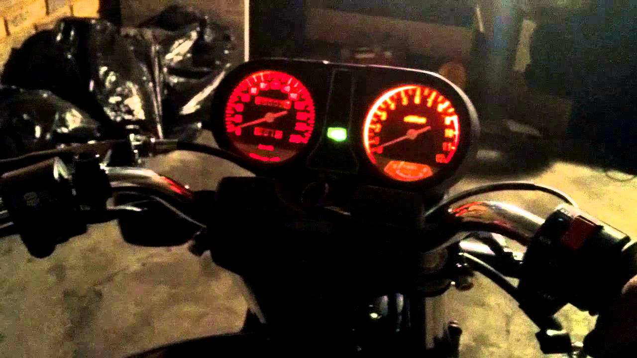

        JENNIFER LIVES

                      Thanks guys, Ed, I believe Pete's love affair with his 450 was probably the most epic around here, and as I recall this all started by you selling me a stator cover to fix a broken stator.
                      So this morning was off to the Classic Motorcycle Club get together, to dig for parts , came out empty handed unfortunately, bought what I thought was a tacho cable, turned out to be a speedo cable....damn, oh well, now I have a spare one.
                      So I guess a trip to bike hospital, our local bike breakers, is on the cards sometime this week.
                      With the realisation slowly sinking in that all the major work is done and dusted and I am really on the home stretch, today was spent tinkering, taking care of those million and one little things that also seem left to do.
                      The only real jobs left to do are to do the brakes, fab fairing brackets and mount the fairing and fab a rear shock mount and fit the shock, then it is air in the tires and a road test.
                      Fired her up to set carbs and check stator output, happy to say that she is running a healthy 13.5V at idle, ran her up to operating temperature and not a drop of oil leak in sight, I am a happy camper, however she did run out of gas before I got around to setting the idle screws. Oh, after standing the night, with choke applied and no throttle, she fired into a healthy idle within a second of pushing the starter button from ice cold, I am a very happy camper.
                      Watch this space for the road test.
