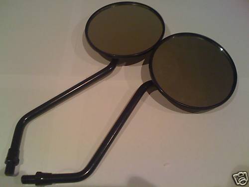

        The mirrors are these..
        ..and the knee pads are these..

                    Oh, those mirrors? Sheesh. they would have sat above my helmet when I was riding.
                    The stems are so long.
                    I got in touch with the seller, explained the situation and he said it was cool to send them back. Lucky me.
                    I was going to go for bar ends but my bars are solid in the ends.
                    So I ordered these instead.
