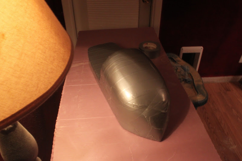

I am going to check it tonight when I get home. I took spyug's advice and just wrapped it in tape then glassed over the top. The poly resin was so smelly/messy, I am thinking for the bottom seat pan I am going to stop by the fiberglass store and pickup some epoxy resin.

Here's a picture of it taped up prior to glassing:
After glassing, I should have done at least twice as many layers. I am going to pickup some epoxy resin and try to add more to the inside. Also it will be cut down about 1/2 an inch.

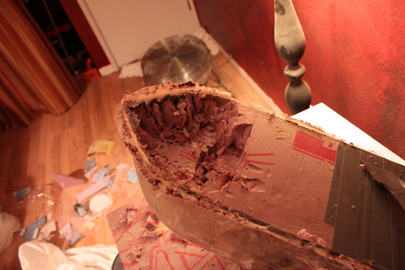

Cutting the mold out of it... it was pretty stubborn. lol don't worry I cleaned the floor up before the wife to be got home...
Mold is out of it, just needs more layers bondo, sand, bondo, sand....

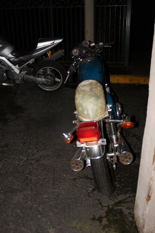

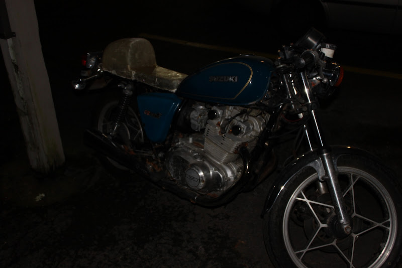

I couldn't resist throwing it on the bike real quick, imagine it cut down about 1/2 - 3/4 of an inch.

NICE JOB... see that wasn't so bad. by the time you get the seat pad and cover on the hump won't look so big. How well did the duct tape release from the Glass?

The glass pulled away from the duct tape pretty easily, i just slid a screw driver around the edges, then pulled the seat part out. once that was out of the way i just carved a handle in the foam to grab a hold of and gave it a few pulls. Took maybe 15 minutes to get the mold out.

Some ideas for the next time. Waxed foil tape would definitely be easier to release the mold from the thing than the duct tape. I forget what kind of car wax to use/avoid, something about certain types reacting with the resin. The sides also look dead vertical, a slight draft angle, like on cast pieces, and you don't have to spend much time trying to dig the mold out of it... leaving a bunch of bits around for the misses to find.

So this past weekend i ended up rolling the GS into my makeshift shop. Pushing a gs up a short hill by yourself is quite the task... going to be much better riding it out of the house lol.
Anyways, I started pulling stuff off of the bike I won;t be using (Blinkers, rear fender, etc) there should be a for sale thread up shortly. I am going to sit down tonight and go though the wiring diagram in my manual.
