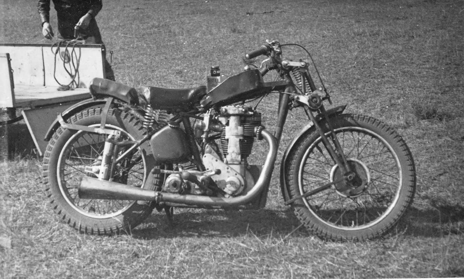

                          Have you considered trailing link suspension for the front?
                          i.e.
                          High res pic here.
                          Or something clever like this? (if this stuff appeals, there's plenty of discussion about this kind of thing here
                            Don't really have the money or desire to look for a girder for a suzuki. If I was building an old pre-unit triumph then I definitely would consider it...
                            I'm not too much a fan of the stuff like that torsional dampner. Just kinda looks goofy to me. I have an 8" over chrome springer from the 70's that I've thought about using and I have some 4.5" over xs650 forks that I may use if I get some triple trees for them...
