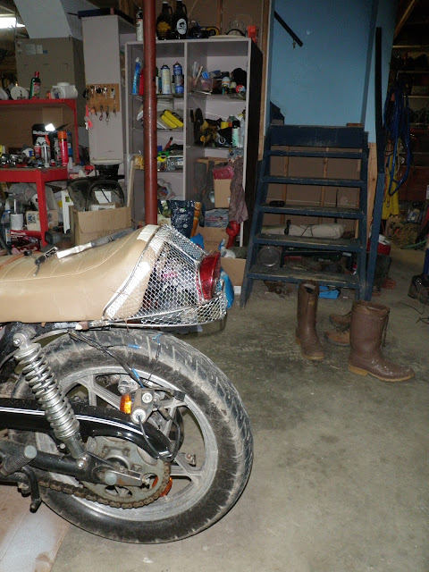

    I also wanted to add I am slowly converting it into a Caf?, but for now I have made it slightly interchangeable. Based on the existing frame I created a rear fender, that I can swap out for the original if I feel the urge to switch between the two.
    Here are a few images of the process I did to create the rear fender.
    Welded Steel Bar Frame
    Wire Mesh Covering
    Fiber glassed and bondo body filler
    Paint and clear coat
    Rear Light from a 94 Suzuki Intruder

                  A little feature I was not expecting. That back fender is just bolted to the seat and has enough clearance with the wires to lift up with the seat, originally I was just going to bolt it all down, but this works too.

                    I've been racking my brains over what to do about my seat for a long time now and I think if I take the idea of what you did for your rear duck tail there and apply it to the original duck tail frame work on my 450, it should solve my problems.
                    The latest idea I had was to chop the very end of my stock seat pan off and weld or rivet an extension on to extend it all the way to the rear of my frame, but I must confess to not being 100% pleased with that idea.
                    If I copy what you've done with yours, I can mould some fibre glass around the stock duck tail frame work in a similar form to the shape of the rear of my tank, meaning I don't need to do anything with the seat pan and I can use the original key lock mechanism to still allow the seat to be removable.
                    So thanks for sharing your work, seems to have solved my dilemma, and I hope you don't mind me copying
                      Completely forgot to ask...
                      The round bar and mesh you used for the rear duck tail, are they anything special? I imagine the mesh would have to be stiff enough to hold its shape while moulding the fibreglass over it.
                      • ITim
                        Hey Pete,
                        Nope nothing really special, I picked both of them up at the local hardware store (Home Depot). I think your local Mitre10 will carry them (I lived in Australia for a little while).
                        The Rod is a 1/4in steel rod, that was pretty straight forward to bend, cut and weld. I'm not really sure what the metal mesh is really used for, but its a "Aluminium Expanded Mesh Sheet".http://shenghuajx.en.made-in-china.c...esh-Sheet.html
                        It holds its shape really well and I just epoxied it to the frame before applying the fibreglass.

                          Cool, thanks for that.
                          Mitre 10 is still around, but we now have a big chain called Bunnings that has a lot more stock, although they can be a pain to shop at because they're usually very busy and not enough staff.
                          I'll have to pay them a visit and see what I can find, and I'm pretty sure they have fibreglassing stuff too.
                          Oh, that was the other one... how many layers of mat did you go with? I would think 3 would be plenty strong enough with the wire mesh...

                              I went in today to get some rod and mesh and managed to get something that should be suitable, but I had to buy a huge length of rod because the short lengths were out of stock (surprise surprise) and I had to buy 10 metres of gutter guard because it was the only thing that looked like it would work... fingers crossed!
                              ITim, a stupid question for you... how did you go about bending the rods? I was looking at that tonight and the only thing I can think of doing is finding something solid that has a suitable curve on it and using brute force to bend the rod around it.
                              Is that all you did or is there some trick I'm missing here? Sorry for the silly question, just never attempted anything like this before...
