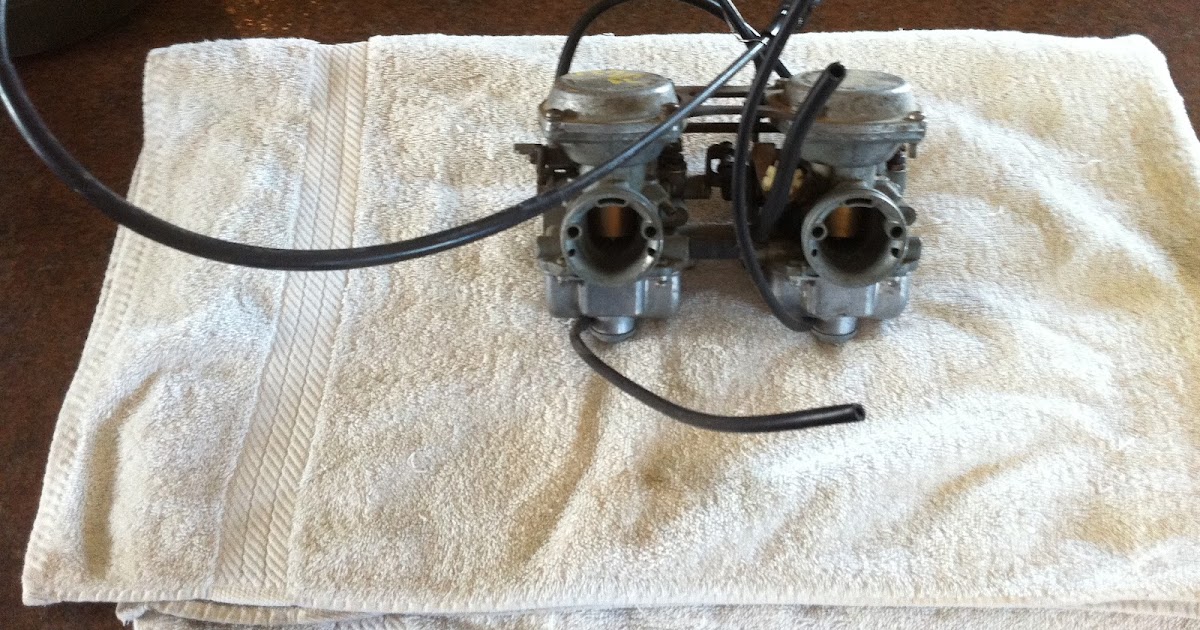

                          I still have the stock jets in the carbs. It stands to reason that since the Harley silencers are way more open (P.O. put those on there and pitched the stock ones) that some tweaking needs to be done to the jetting. I just got the intake gaskets, o-rings, carb boots, and clamps replaced so hopefully that will help the idling/running too. I haven't messed with the jetting yet as I am not sure that I really want to keep those HD silencers on there as they are pretty heavy. I am goign to go through and try vacuum synch the carbs in the next week and see if the new intake hardware made a difference. I'll post an update when I do get to that.

                            If your carbs aren't in sync, the sync will make a big difference... at least it did on mine... well worth it.
