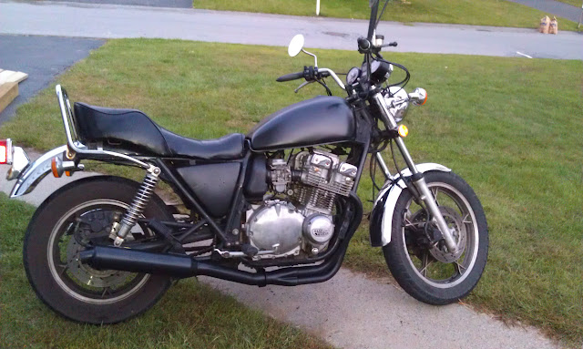

    Hi. This is a great site, so much awesome info crammed into it. This is both my first bike AND my first build. I've spent a good while reading up and finally got some garage space, so I went to town! My buddy's tearing down his Yamaha, too, so we've got a pretty cool setup. Anyway, I'm going to try and keep you posted and any hints/tips/reminders to slow down are greatly appreciated!
    Pretty nervous about all these wires haha!
    I also got the gages off and some other assorted stuff...
    There's the bike when I got it. Needed a good scrubbing, that's for sure.
    I gave it a once over and some quick paint just to get through the season. Now it's time to really get going on it!

          Thats better, looks like you have been busy on it already, a great improvment just with a clean up.So what are your winter plans for her?

            Looks good. How did you scrape up your pipes to paint them?
            • jacobdub
              The pipes were already painted, so I just hit them with a wire brush.
