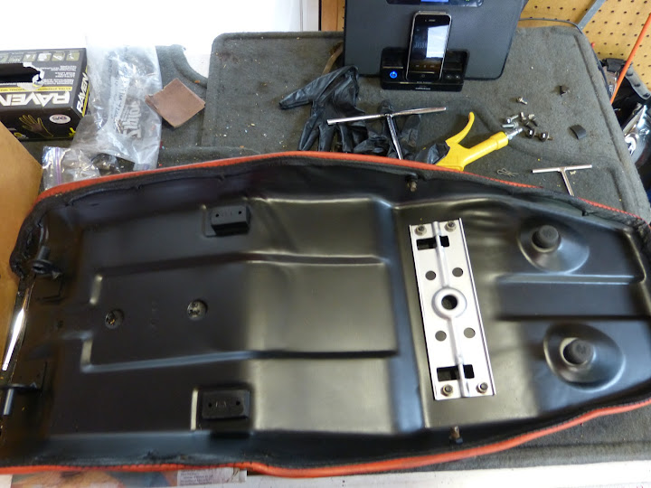

I finished getting the seat all ready. Looks so nice it's a shame you don't get to see this part most of the time.

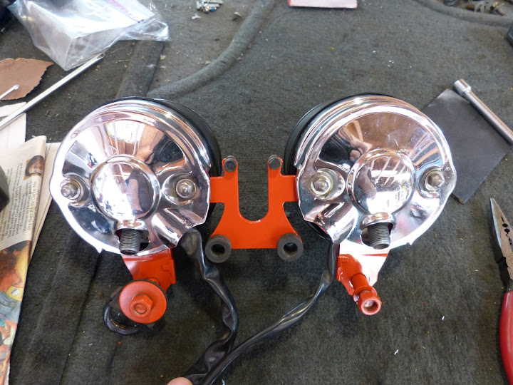

The headlamp assembly is ready with a new shiny paint job...
And so far, my electronics appear to be working after breaking down the loom, rewrapping, cleaning the connections, fixing the broken ones, and adding new ones where the PO cut them out. Woot!
