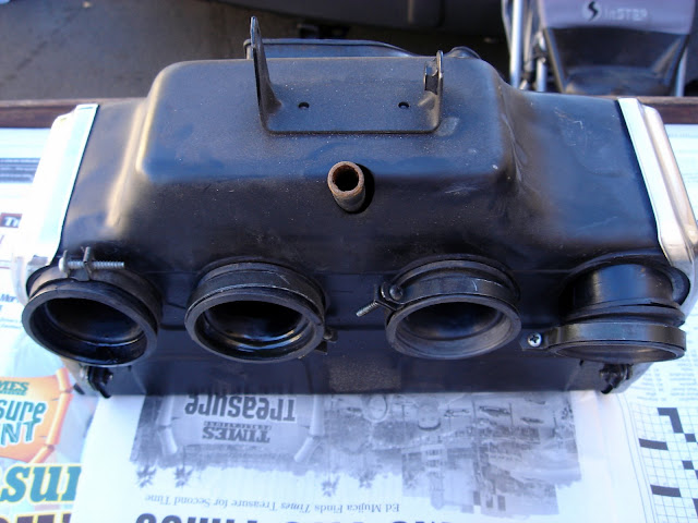

      I plan on keeping the stock airbox, and I've been reading the sealing DIY on basscliffs website. However, my bike is older than the one in the DIY, and the part numbers listed, I think are for newer bikes.
      Does anyone know where I can find the part numbers for the airbox boots? I've looked BLVD suzukis website, and in the diagram it doesn't have a listing for the boots.
          I think you're SOL unless you find good used ones/whole airbox on ebay or salvage. Here's a recent thread with that conclusion. You can try some of the tricks listed there though to soften up the ones you've got. I like the hallowed out cafe look of pods and battery hidden in the seat hump, but I can appreciate simpler tuning.

            Damaged airbox boots was a big reason that I went with pods. My intake system is leak free now
              I don't feel comfortable re-jetting my carbs myself, that's what scares me.
