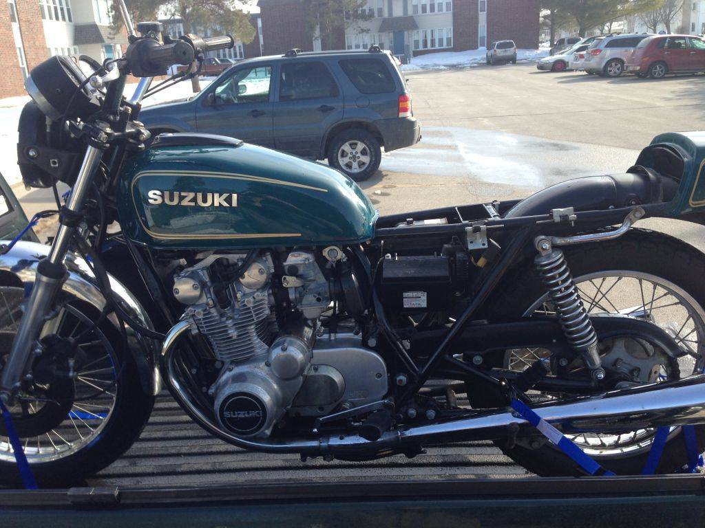

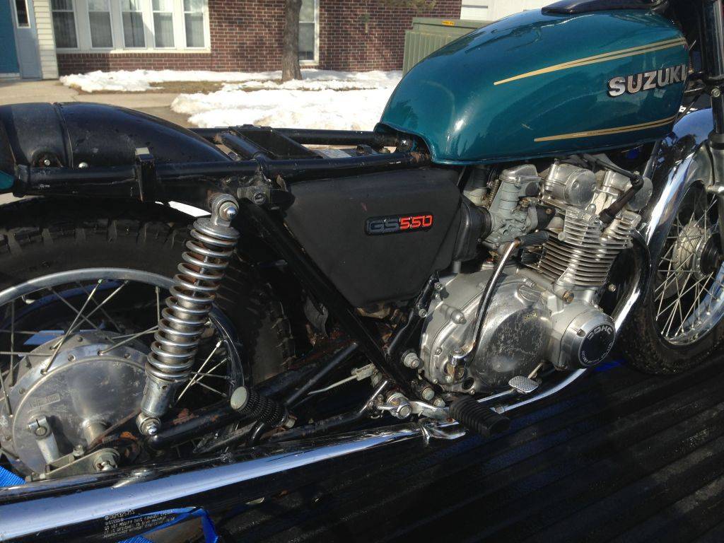

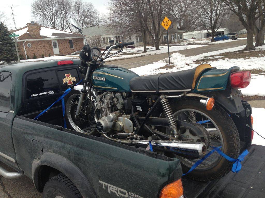

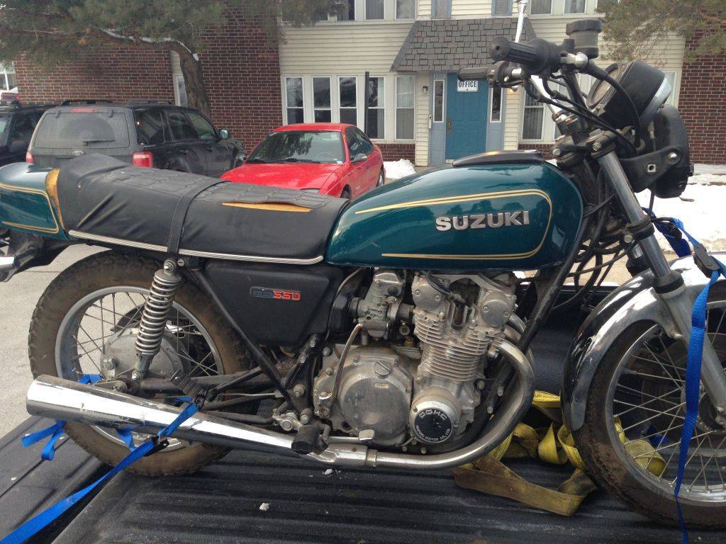

    Hello all,
    Here is my 2nd GS project. It's a beauty.
    What I know:
    Points are good, carbs are clean, brand new battery, tank is clean, everything is here.
    The issues:
    It won't start. No spark on 2 cylinders. Needs a seat cover, mirror, headlight bulb, cleaned and polished.
    • 35811
    Wow, bike looks to be in nice shape.
    Unless you did the work on it, I wouldn't believe it.
    Good luck
    • isu2014

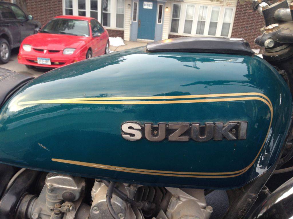

      It's all original so it has a few flaws but it's even better than I originally thought. It will polish up really nice I'm sure.

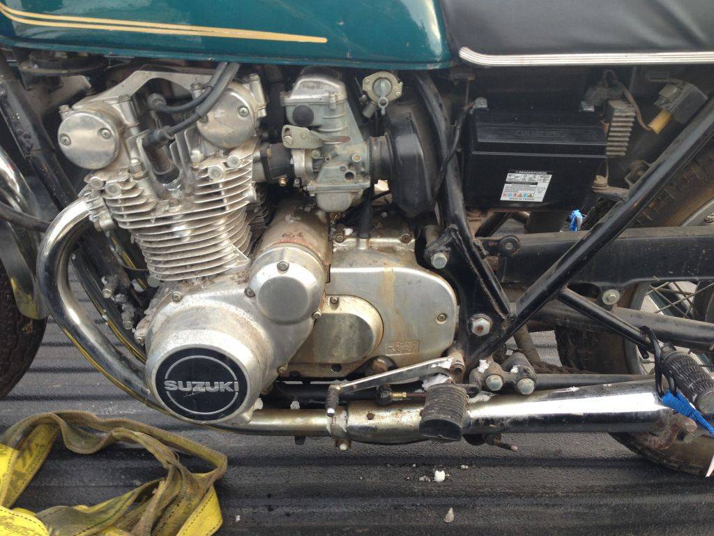

      • isu2014

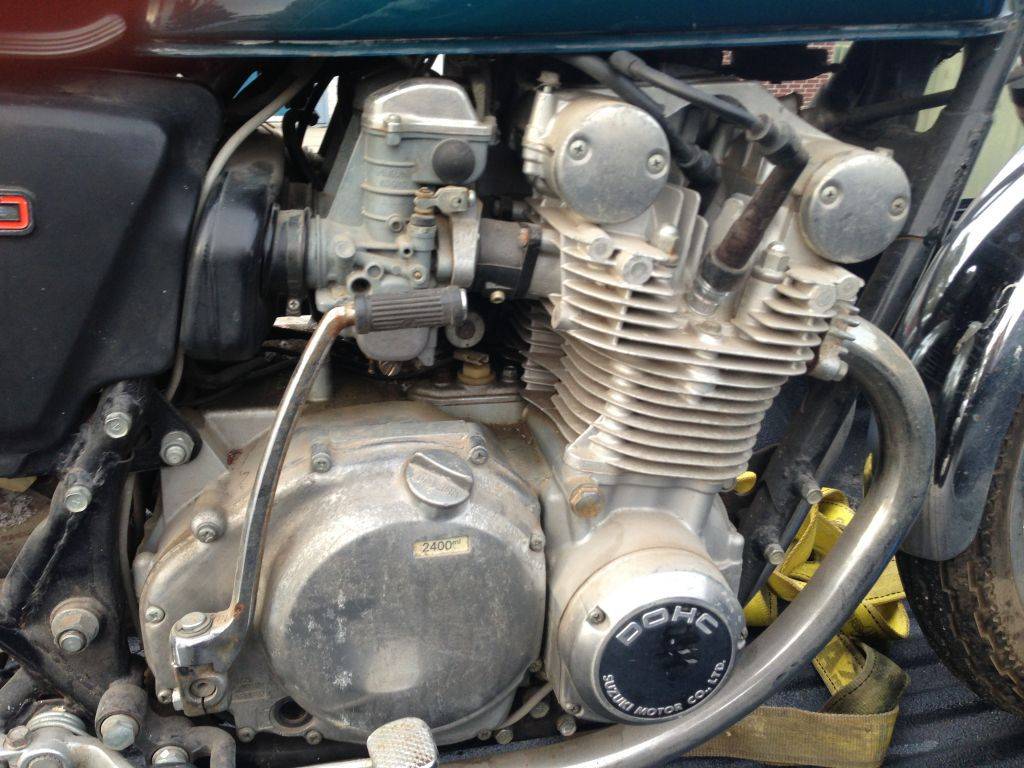

        I washed the bike today before I unloaded it. Easier to get to the car wash... Not much rust to polish off but the engine case has some corrosion but not too bad.

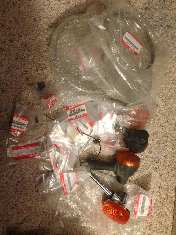

            I was just looking through the box of miscellaneous parts the dude handed me when I bought the bike. I didn't know what was there besides the headlight trim rings. Turns out he ordered over $200 worth of NOS Suzuki parts. Headlight rings, chrome turn signals, a bunch of fasteners and some other stuff. Not bad.

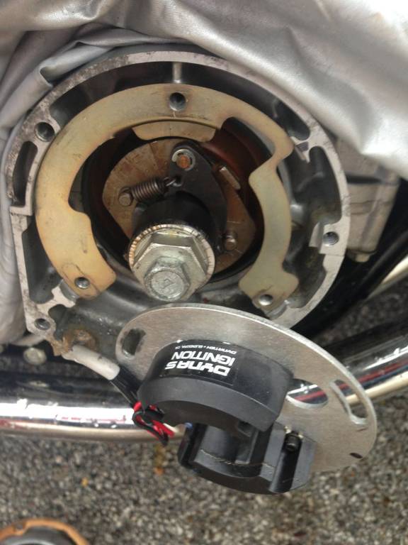

              Found something shocking when I was going to check the points that the guy said he checked and verified. Dyna S. This is a game changer. I don't know squat about this system. I do know the bike still has original coils, which I don't think are good for this system.

                  • 35811
                  The Dyna S is designed to work with stock coils.
                  • isu2014
                    Yeah I guess I was reading that after I did some research. Of course Dyna wants you to buy their coils but probably not necessary.
                    The bike is buried in a snow bank now after a few days of crappy weather, covered of course. Won't get to work on it until this weekend. The previous owner claims he checked spark on all cylinders and only 1 and 3 have spark. One coil powers 1 and 4 and one coil powers 2 and 3, so what would cause only half of the coil to fire? A bad Dyna S? Incorrect timing? Bad coils? Like I said, I don't know squat about this setup.

                      Check the wiring to make sure all in good order. Wire from Dyna S to coil, coil ~ plug wire to cylinder. Go to BikeCliff's Website and you'll find all the info to troubleshoot the problem.

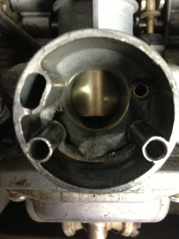

                            I got the bike running but only on full choke. Definitely needs more gas. It pops when I give it gas and won't rev very much. The timing is probably off too but it's hard to tell when it doesn't run well to begin with. I took a video of it. Sounds like it might be missing but I'm guessing one cylinder isn't getting much gas at all.
                            • isu2014
                              I brought it back inside and took the carbs off. I found some oil in carb 2. Probably needs a valve job.
