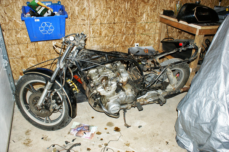

    So I needed a work bench before I could start, so I threw together one from some scrap wood I had in my garage. and I started some teardown before bed. I thought alot of it was too rusty to salvage, but it's looking pretty good.
    Here goes nothing.

                Here are a few more tear-down pics.
                My In-laws were in town for a few days and I have more visitors coming soon, so not a lot of time. You will also notice the bike crammed in a corner with stuff pilled in a couple of pictures (my garage is continuously offered up for temporary storage) so not always convenient for working on a bike.
                In the photo below, one of the previous owners put in a balance line for the forks with a guage (busted) and one rusted shut schrader valve. I think I will be losing that on the build up.

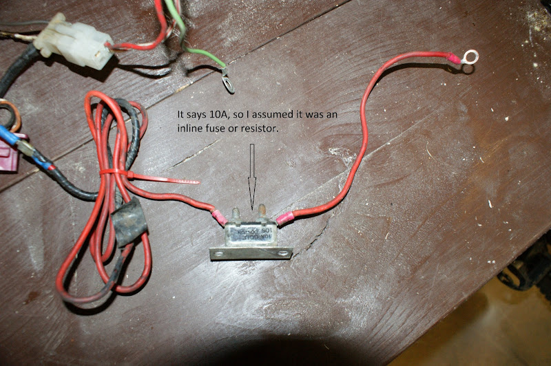

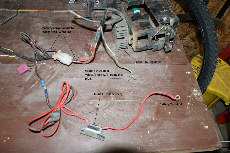

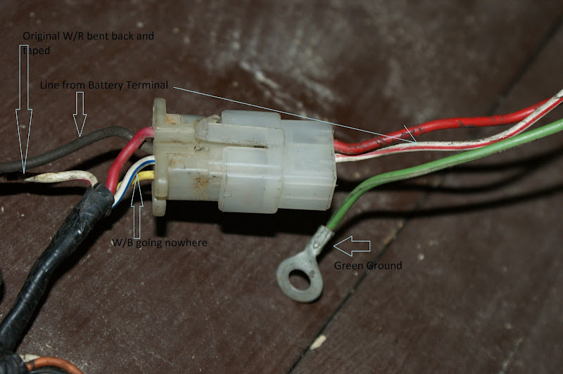

                    So, I went out to the cave to do some organizing and try and make some sense of a few electrical "mods" done by some previous owners.
                    And what do I find, but a replaced R/R. Great, right? Well... see for yourself...
                    So, I thought at first there was an inline fuse with this "mod", but then realized half way through editing these photos that it was more likely an inline resistor.
                    Any input would be helpful, not exactly sure what should be done. I figure I can eventually figure it out, but I also figured it might be easier on here. Also, as mentioned, I am going to be re-wiring this mess and will be tidying this up either way.
                      Also just realized I may have added the resistor and battery terminal chunk to the whole thing. Not certain they were connected, it just looked right when trying to figure ou the mess of wires. I guess I should have taken more pictures when stripping it down.
                      Again, any help would be awsome.

                              Ok, So after some sleep, fiddling around and some research, I found out what the wires for my R/R are and what they're supposed to do. 3 Yellow go to AC Generator, Green Ground (Duh), Red to Fuse (No Change), Black to 12V Ignition Power. So, during my re-build I think I'll just make it a little cleaner looking and all will be ok.
                              Here's to hoping.
