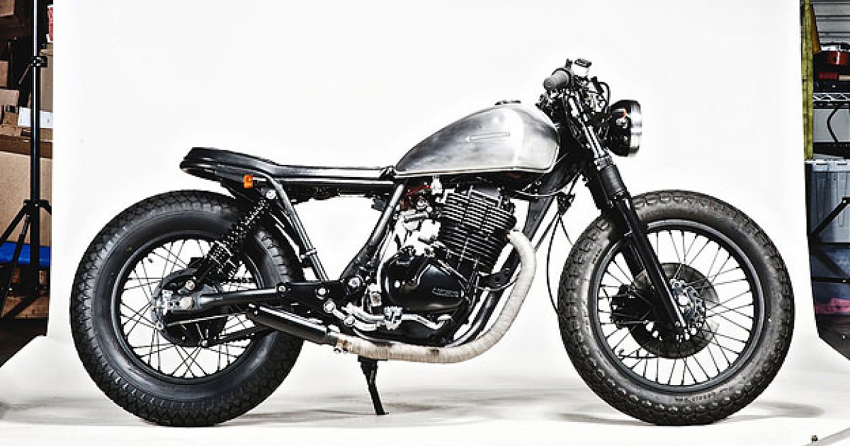

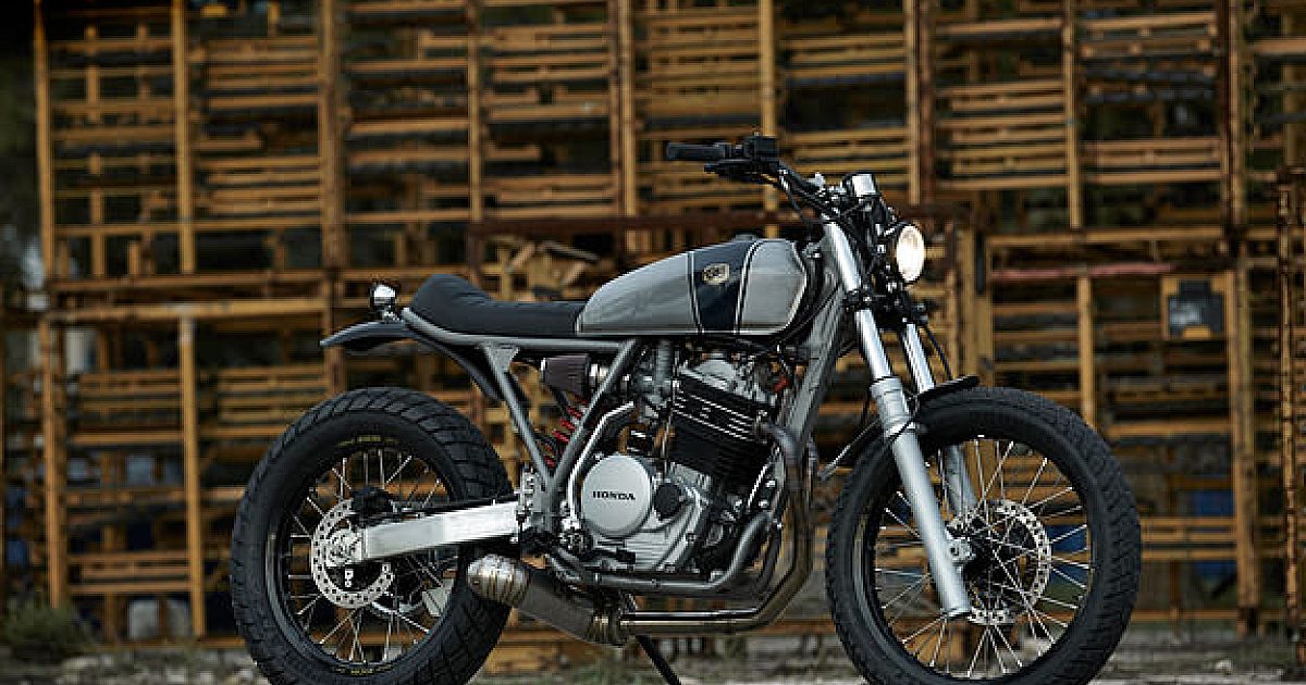

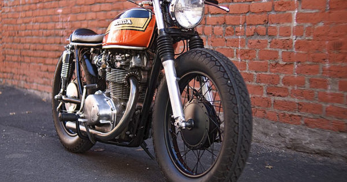

                              So, I have been shopping, and building up my wish list. Which brought me to the issue with my seat pan. (I will post pictures of it tonight). It is rusted pretty bad. Especially right where one of the mounting pads is supposed to go (that's right, no pad). Now, I have found more seat covers for this bike than I could possible imagine, but finding a seat is quite hard.
                              So, I decided to make my own... well with some help from my metal bashing friend. And then I figured, if I was going to change the seat, why not more. Well, here is some of my inspiration (One of my co-workers/friends introduced me to this site)
                              Eric Meglasson lives in Bend, Oregon, and his motorcycling journey has had its fair share of twists and turns. “Over the years, my bikes kept getting…
                              Tony Prust of Analog Motorcycles has built his reputation with a raft of elegant, mid-capacity customs: the perfect bikes for barhopping and cruising…
                              Here’s the latest custom to roll out of the Madrid workshop of Cafe Racer Dreams. Once again, there’s an off-road influence—but this time, the Spanish…
                              I’m starting to wonder if the NX650 is set to replace the CB750 as the favorite Honda platform for custom builders. In Europe, a Honda Dominator is easy…
                              So, What do you guys think?
