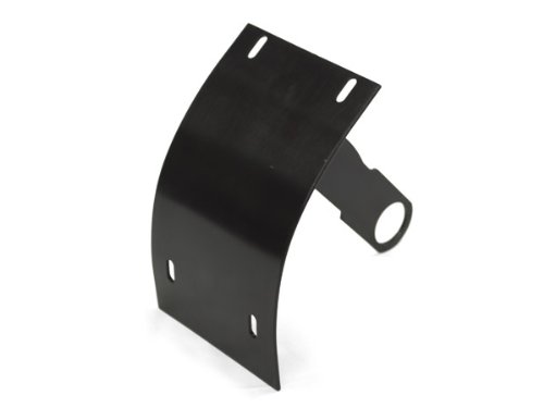

                  I'm thinking I might put the license plate vertical off of the axle or something.
                  With a mount plate like this.
                  Looks like this.
                  Maybe not, because it might **** off local LEO's. But just a thought. Since the Texas law says plate must be readable from 200ft. They might get me for not having a light on it, or it being too hard to read from 200ft. I need to get a sheet of steel to make a "fender" under the seat to protect the airbox and electronics. Might as well use the rest of the steel to fashion a license plate mount.
