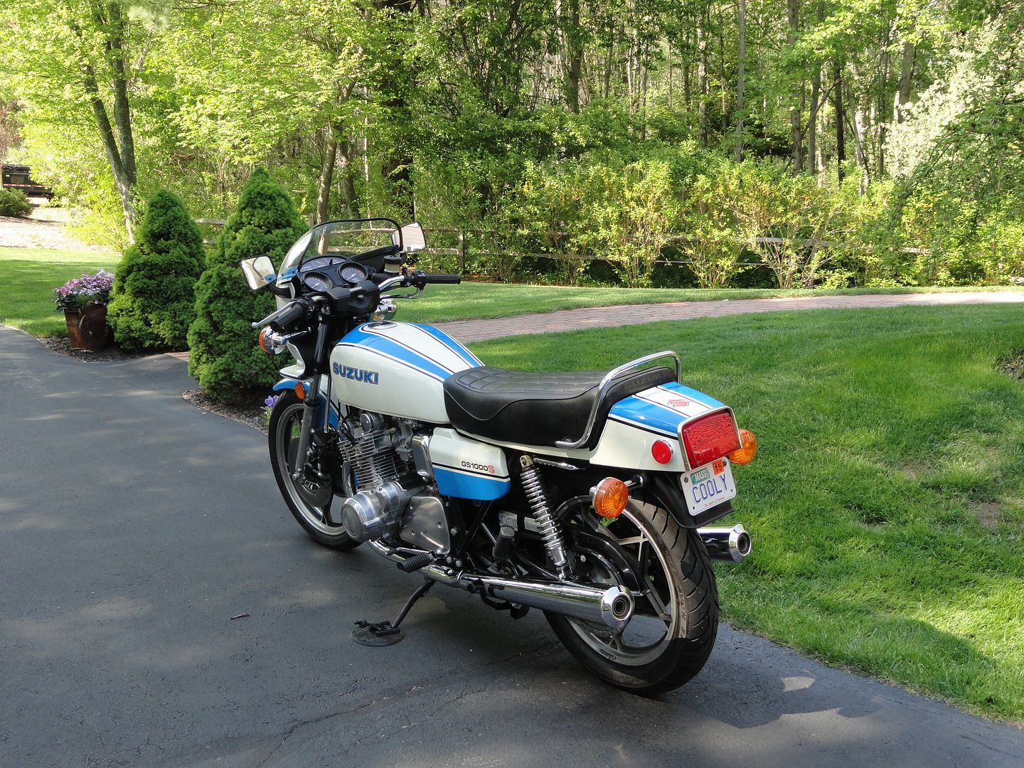

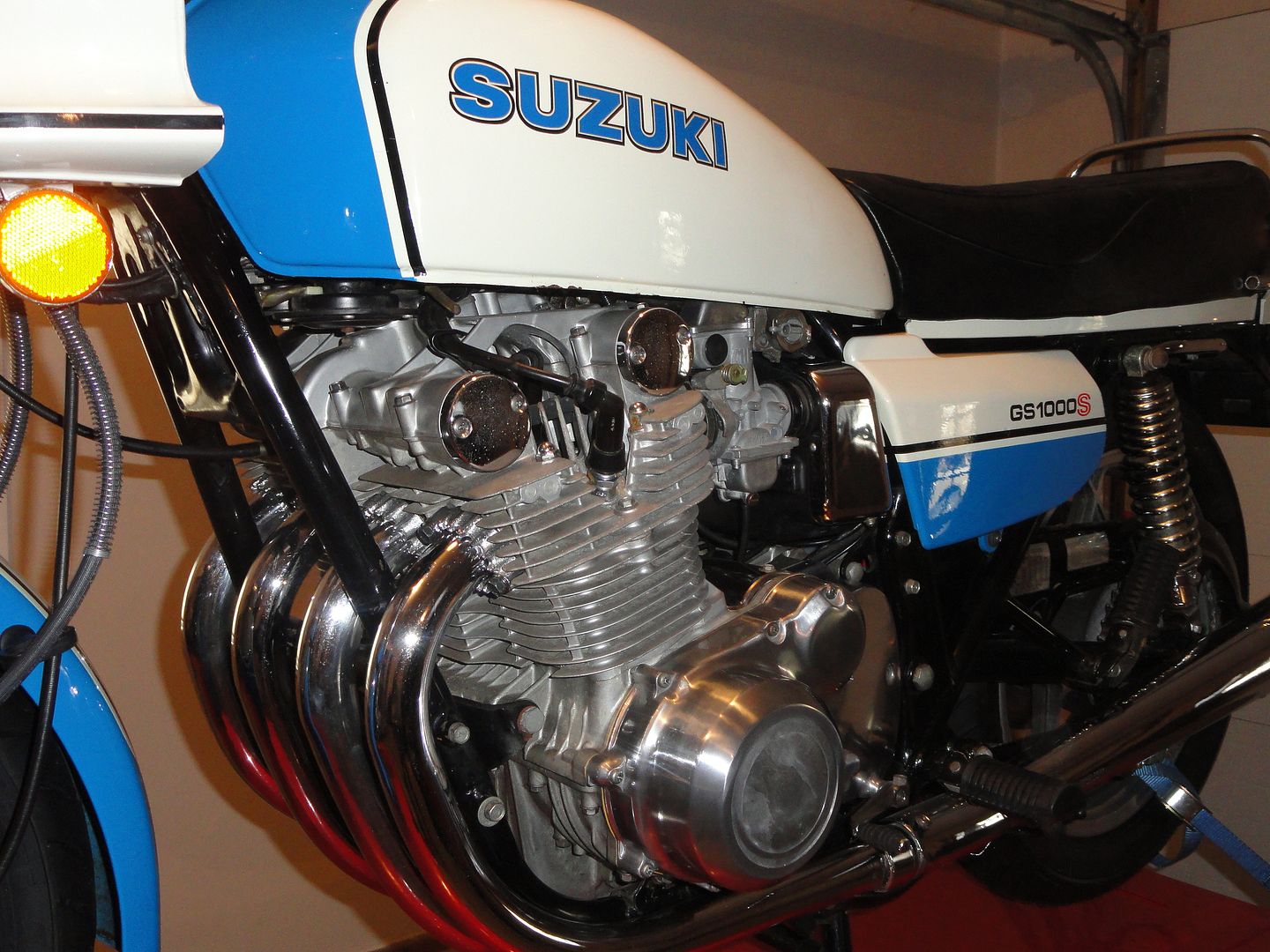

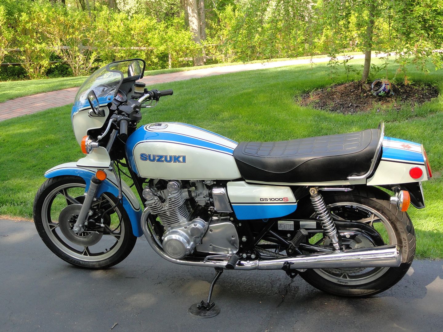

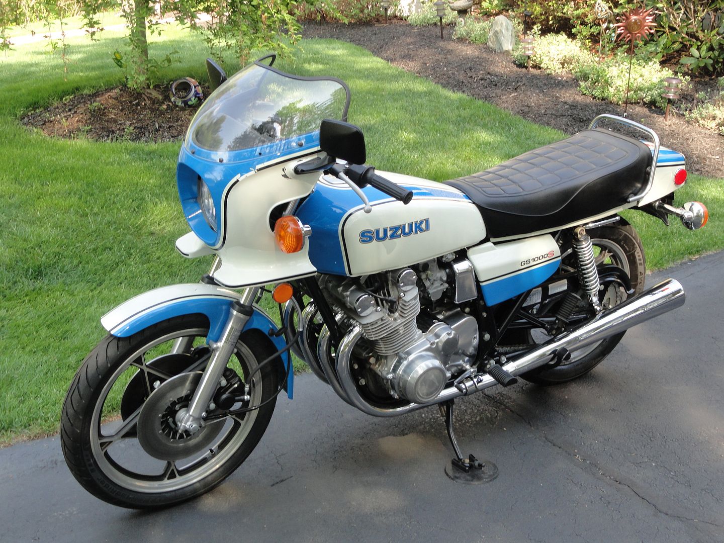

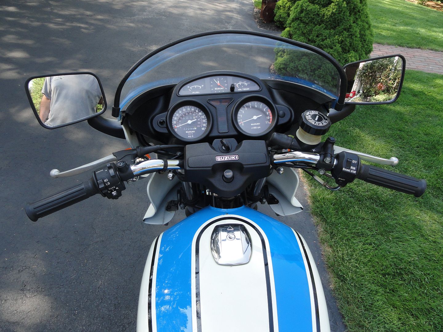

                    Before and after shot of the gauges and a few how it sits today.
                    • Vmass
                      • Apr 2011
                      • 6102
                      • Massachusetts
                      #115
                      Kind of funny and embarrassing.......I have only cleaned and done basic maintenance, what some of you guys would call a weekend has taken me almost 18 months!
                      Gotta go get the ham cooking.....Happy Easter.

                        #116
                        Rich, that has turned out very nice, those pipes look fantastic, what an improvement from when you picked them up.
                        Hopefully it rides as good as it looks.
                        Too bad the clock knob is missing on that one as well, I am fortunate to still have both of mine. (edit, just noticed you do have the clock knob on the refinished dash, I was looking at the "before" picture, were did you find that one?)
                        I was undecided on repainting the Canadian Cooley when I was restoring it as it was less than perfect.
                        I even purchased the decal set but I have left both the CC and the Boise Beauty original and it was the right decision for me.
                        Once back together it just seems OK that it's not 100% perfect and I never notice the minor nicks, if it had dents or road rash that makes it a no brainer to repaint.
                        Maybe just have the fairing redone or is there other parts that need work?
                        Look forward to a ride report.

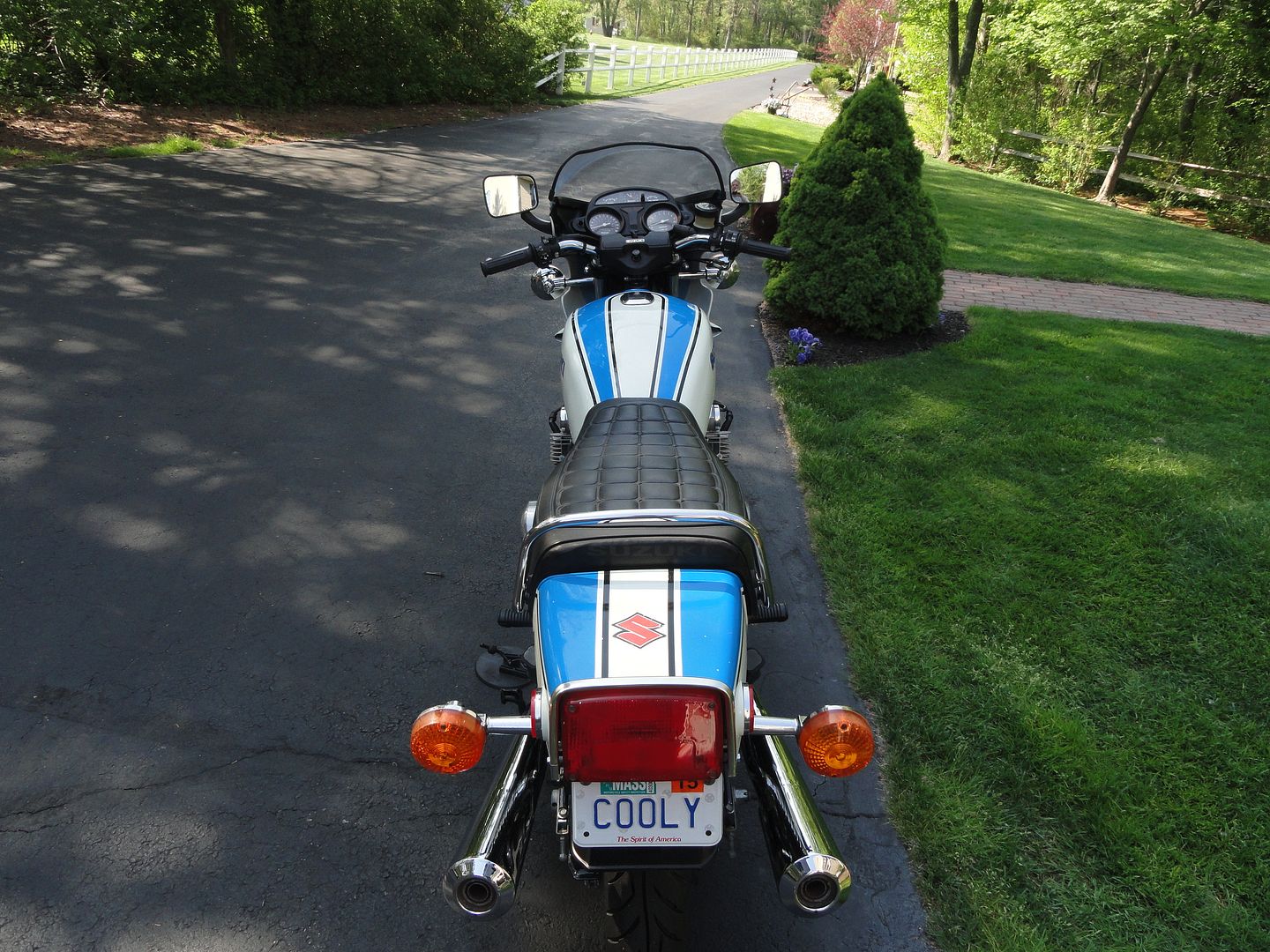

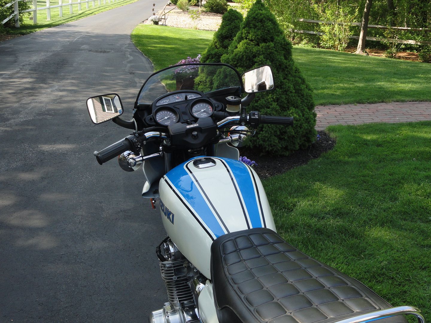

                            #118
                            Excellent pics of your great looking S.
                            Don't think i have seen a similar front photo with the shading. Beautiful.
                            The matching tie-down is a nice touch.
                            • Vmass
                              • Apr 2011
                              • 6102
                              • Massachusetts
                              #119
                              Thanks Steve..... I am not sure why that front shot came out with the shading, I took all the pictures in the same mode.

                                #120
                                The 2,298.7! The bike is running well. Brakes are a little spongy, I will give them another bleeding.
                                There is something tweaked in the front end, the bottom portion of the fairing hits the tank when turned all the way to the left. I am not sure if it is from when the bike went down on the left side (many years ago) or if it is tweaked from when I reassembled it after rebuilding forks.
                                Joe?
