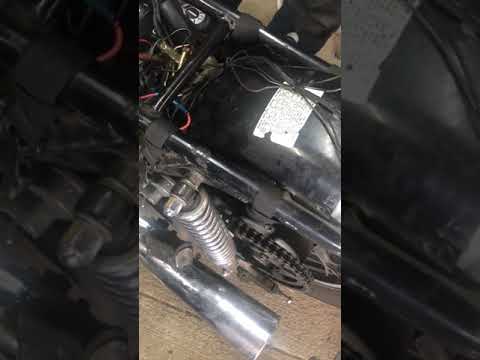

            Well, the bike is back together and finally running.
            Bike Reassembled by Scott Baker, on Flickr
            I didn't get it out on the road yet today but will after I put the license plate back on and wax the chain tomorrow after work. After we ran the bike in the video above and then let it sit for about 20 minutes, I grabbed the Harbor Freight compression tester and numbers are at 89/89/89/92 for each cylinder. This puts the numbers about what they were when I tested it with oil and the bike cold (remember that hot numbers with that tester were in the low to mid 70s). I'll test it again later this week with both the HF tester and one I'll rent from O'Reillys. However, I think that for now the compression numbers look better.
            I hope we have solved her problem but only time will tell. One fix was verified though - her gas gauge is working again.
